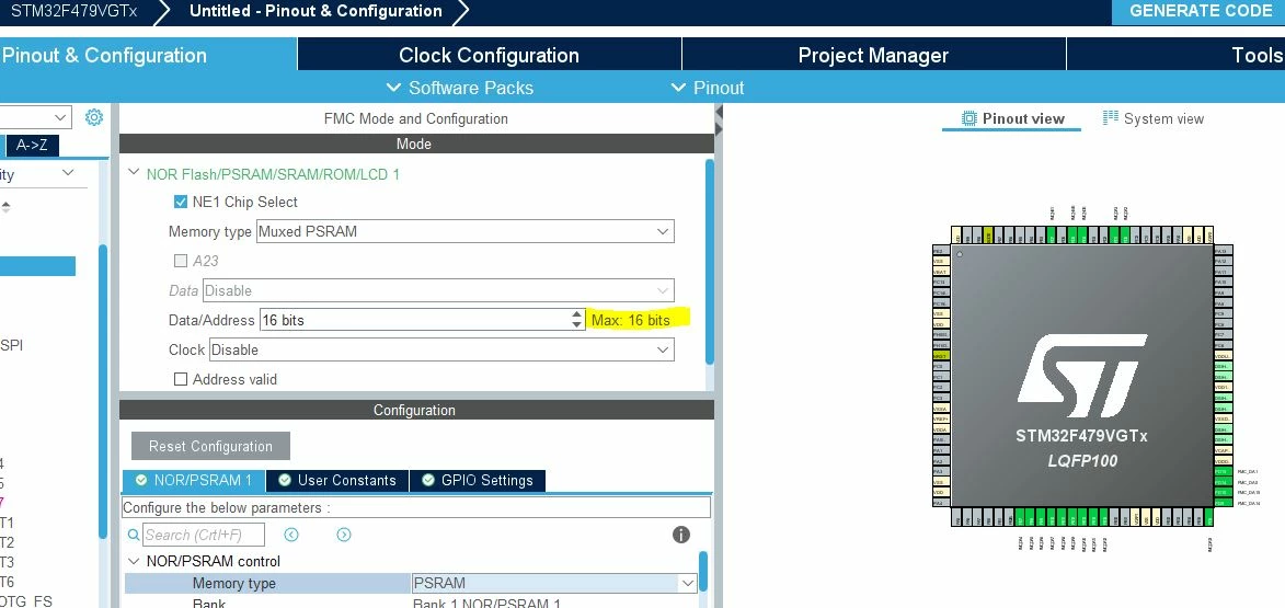

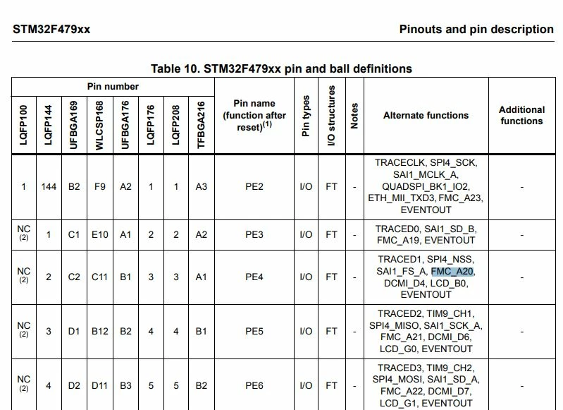

Hello @Dany​ ,
Which package are you using ?
It depends on the package that you are used.
You can check the PSRAM configuration and address max with STM32CubeMX.
For example, with LQFP100 package : Max 16 bits for Muxed PSRAM.
0693W000008ynGAQAY.jpgYou can refer to the Table 10. STM32F479xx pin and ball definitions in the STM32F479xx datasheet to check the PSRAM address pins.
