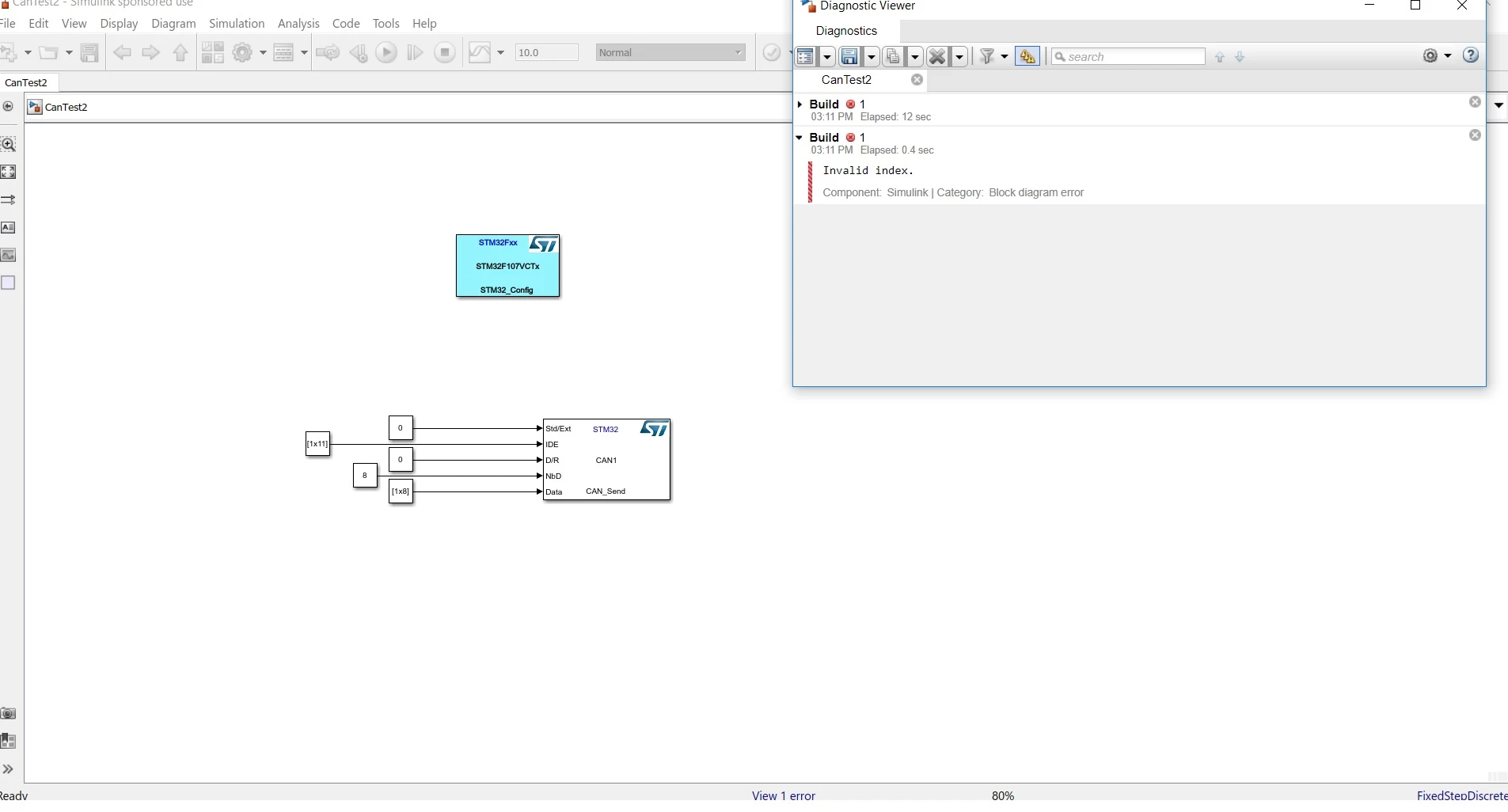

I'm trying to use the STM32 MAT/TARGET to setup a Communication between Simulink and a STM32f107vct via CAN.
When I want to build the Simulink model i get an "INVALID INDEX" Block Diagram error.
I am using Matlab R2018b and the latest version of STM32CubeMx.
Do you have documentations concerning CAN setup with a virtual and a hardware channel in Simulink?

    Mathworks are aware about the bug: https://nl.mathworks.com/support/bugreports/1895608?s_tid=srchtitle
    Or more detailed for STM32-MAT:
    https://nl.mathworks.com/matlabcentral/answers/431624-customized-hardware-implementation-causes-a-simulink-error-invalid-index-with-2018b
    The question is now who can implement this workaround in the toolchain?
