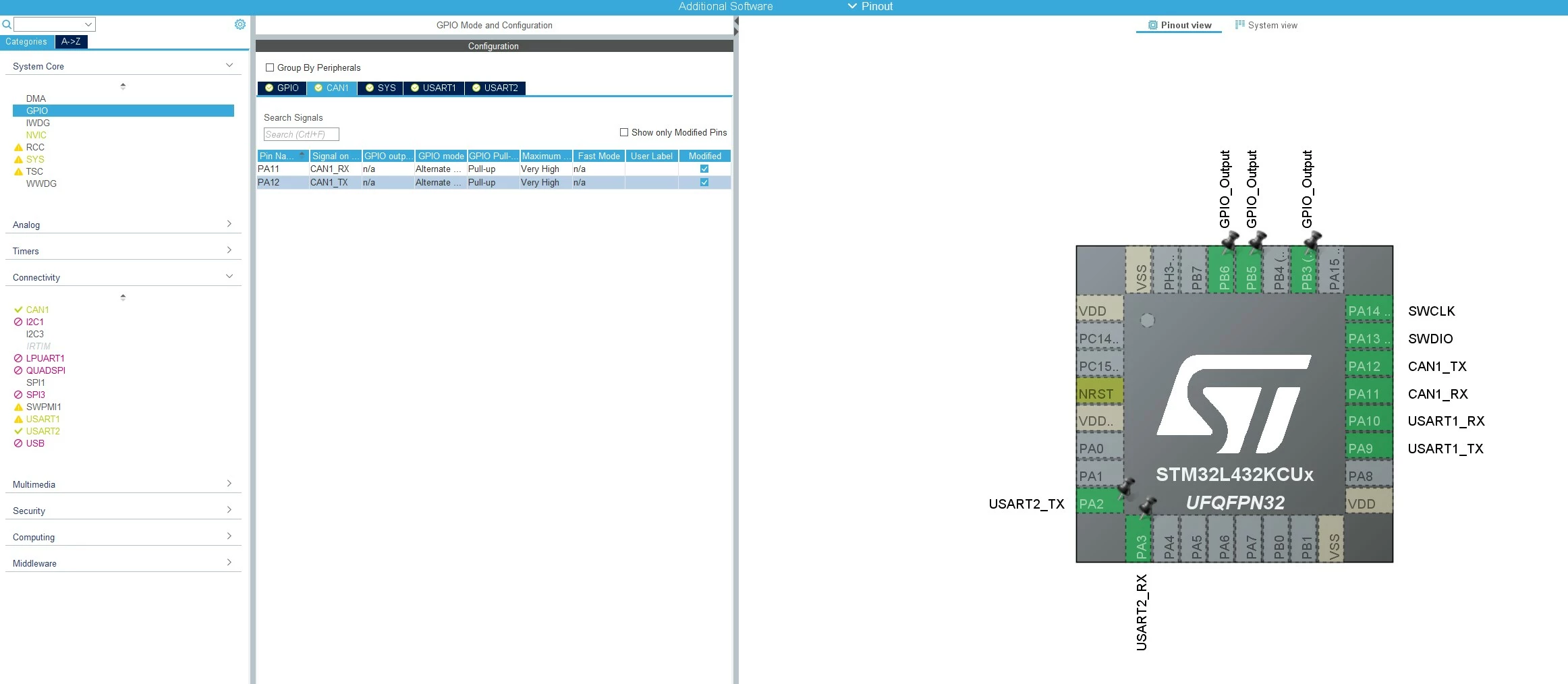

Hello, I have configured project in CubeMx for above mentioned board using HAL library with 2 UART lines and CAN.
CAN line connected to Kvasar CAN dongle via this transciever https://www.ti.com/lit/ds/symlink/tcan1042-q1.pdf. While CAN transmit works perfectly, reception does not work at all. No interrupts for CAN FIFO message pending or any errors generated. Checked during debug mode in registers also. Termination resistor is also used.
Checked Rx line from transceiver to the board and CANH/CANL. Singals are present. Interrupts are enabled as well.

CAN init:
static void CM_CAN_SetFilter(CAN_HandleTypeDef * hcan);
/* USER CODE END 0 */
CAN_HandleTypeDef hcan1;
/* CAN1 init function */
void MX_CAN1_Init(void)
 hcan1.Instance = CAN1;
 hcan1.Init.Prescaler = 4;
 hcan1.Init.Mode = CAN_MODE_NORMAL;
 hcan1.Init.SyncJumpWidth = CAN_SJW_1TQ;
 hcan1.Init.TimeSeg1 = CAN_BS1_11TQ;
 hcan1.Init.TimeSeg2 = CAN_BS2_4TQ;
 hcan1.Init.TimeTriggeredMode = DISABLE;
 hcan1.Init.AutoBusOff = DISABLE;
 hcan1.Init.AutoWakeUp = DISABLE;
 hcan1.Init.AutoRetransmission = DISABLE;
 hcan1.Init.ReceiveFifoLocked = DISABLE;
 hcan1.Init.TransmitFifoPriority = DISABLE;
 if (HAL_CAN_Init(&hcan1) != HAL_OK)
 Error_Handler();
 HAL_CAN_Start(&hcan1);
 if(HAL_CAN_ActivateNotification(&hcan1, (CAN_IT_RX_FIFO0_MSG_PENDING | CAN_IT_RX_FIFO1_MSG_PENDING
 | CAN_IT_ERROR | CAN_IT_TX_MAILBOX_EMPTY | CAN_IT_ERROR_WARNING | CAN_IT_ERROR_PASSIVE | CAN_IT_BUSOFF)) != HAL_OK)
 Error_Handler();
void HAL_CAN_MspInit(CAN_HandleTypeDef* canHandle)
 if(canHandle->Instance==CAN1)
 /* USER CODE BEGIN CAN1_MspInit 0 */
 /* USER CODE END CAN1_MspInit 0 */
 /* CAN1 clock enable */
 __HAL_RCC_CAN1_CLK_ENABLE();
 __HAL_RCC_GPIOA_CLK_ENABLE();
 /**CAN1 GPIO Configuration
 PA11 ------> CAN1_RX
 PA12 ------> CAN1_TX
 GPIO_InitStruct.Pin = GPIO_PIN_11|GPIO_PIN_12;
 GPIO_InitStruct.Pull = GPIO_PULLUP;
 GPIO_InitStruct.Speed = GPIO_SPEED_FREQ_VERY_HIGH;
 GPIO_InitStruct.Alternate = GPIO_AF9_CAN1;
 HAL_GPIO_Init(GPIOA, &GPIO_InitStruct);
 CAN_FilterTypeDef CAN_FilterInitStructure;
 /* Default filter - accept all to CAN_FIFO*/
 //CAN_InitStructure.CAN_Mode = CAN_OperatingMode_Initialization;
 CAN_FilterInitStructure.FilterActivation = DISABLE; // Disable filter
 CAN_FilterInitStructure.FilterBank = 0; // 0..13 for CAN1, 14..27 for CAN2
 CAN_FilterInitStructure.FilterFIFOAssignment = CAN_FILTER_FIFO0;
 CAN_FilterInitStructure.FilterMode = CAN_FILTERMODE_IDMASK;
 CAN_FilterInitStructure.FilterScale = CAN_FILTERSCALE_32BIT;
 CAN_FilterInitStructure.FilterIdHigh = 0x0000;
 CAN_FilterInitStructure.FilterIdLow = 0x0000;
 CAN_FilterInitStructure.FilterMaskIdHigh = 0x0000;
 CAN_FilterInitStructure.FilterMaskIdLow = 0x0000;
 CAN_FilterInitStructure.FilterActivation = ENABLE;
 HAL_CAN_ConfigFilter(hcan, &CAN_FilterInitStructure);

One thing I found during debug is that FINIT bit in CAN_FMR register is always 1 and in the manual there is a note: "Note: When FINIT=1, CAN reception is deactivated."
https://www.st.com/content/ccc/resource/technical/document/reference_manual/02/35/09/0c/4f/f7/40/03/DM00083560.pdf/files/DM00083560.pdf/jcr:content/translations/en.DM00083560.pdf
page 1622. I have tried to set it to 0 during debug, but no changes. From the other hand HAL driver should care about it anyway.
Any suggestions?

Problem solved.
The cause was incorrect initialization sequence, particularly filters were initialized before CAN went to state READY.
NOTE! I have seen in couple of threads about filters suggestion to not initialize it all. However, this is not the case. IN fact not initializing filter will lead to disabled Rx line.

First figure out why FINIT bit stays set always, after solving that it might work allready. Like you said you won't receive anything while it's set.
You can step throught the function which sets filter with debugger and look what happens.​
