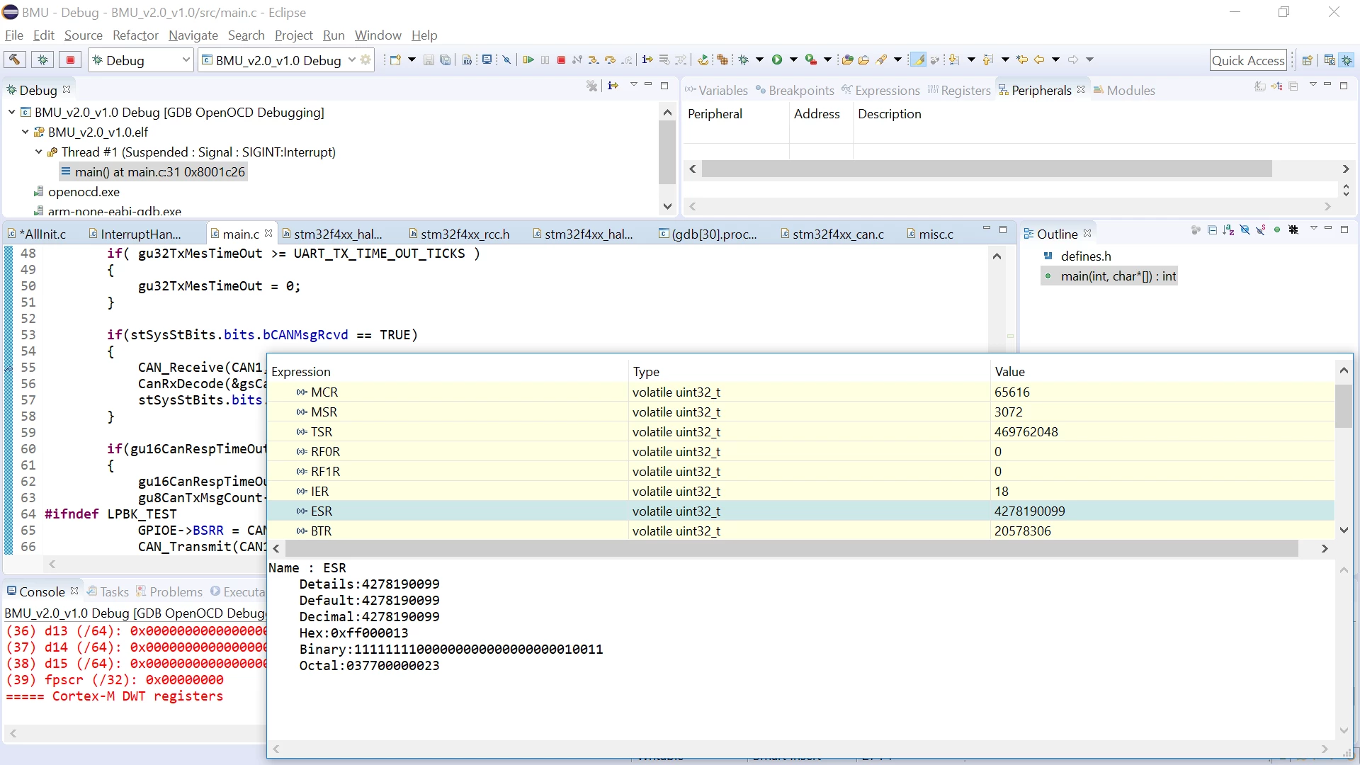

I'm working on STM32F412VET6 micro, & Configured CAN1 for communication & it is initialized as
500Kbps, 75% Sample, ABP1 is @ 24MHz

I'm able to transmit a CAN frame, but when I try sending a CAN frame from CAN analyzer i'm getting receive error
Any idea where am I going wrong.

    I would start with a scope, to check the bit rate first.
    can you work on the receiver first, it is the fastest way.
    that way you know the bit rate is correct and your code is the problem.
