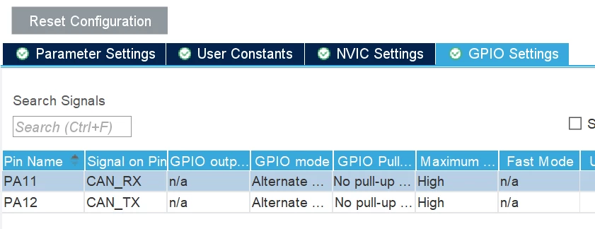

I generated the HAL with CubeMX. RX1 interrupt is enabled and the pins are left as default:

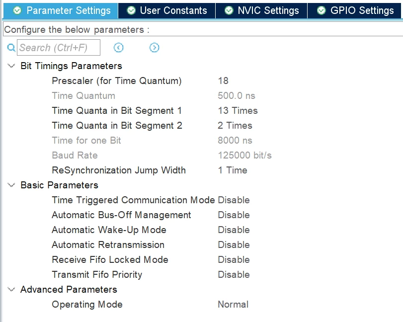

The bus is running on 125kbits/s and is configured as follows:

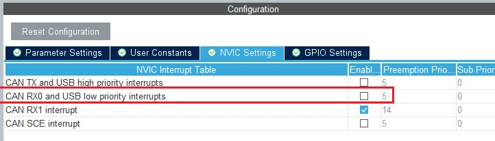

I receive the HELLO message on the pi, so I conclude that the hardware setup is properly done. However, when I send a message from the Pi, it is never received on the stm side. I played around but the interrupt was never received. I added a second Pi and there I could actually see the message. So I'm sure the message is sent from the Pi.

But looking at your code, I found the issue:
You're using FIFO0 while, the interrupt is configured for FIFO1. So you need to activate this interrupt for FIFO 0 (RX0):
Hope it does answer your question.
