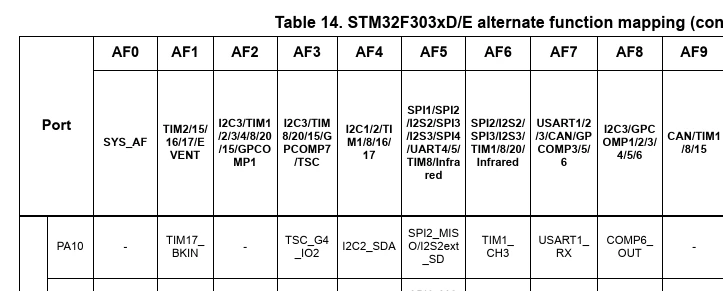

I just tried, on F303 :
Cube allows only comp6 output on pin PA10, usart1 rx then on pin PB7; need wire to connect.

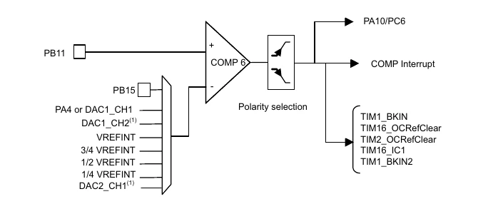

And from rm see possible internal connections:
-> no internal connection to any uart - so not possible by internal mux .

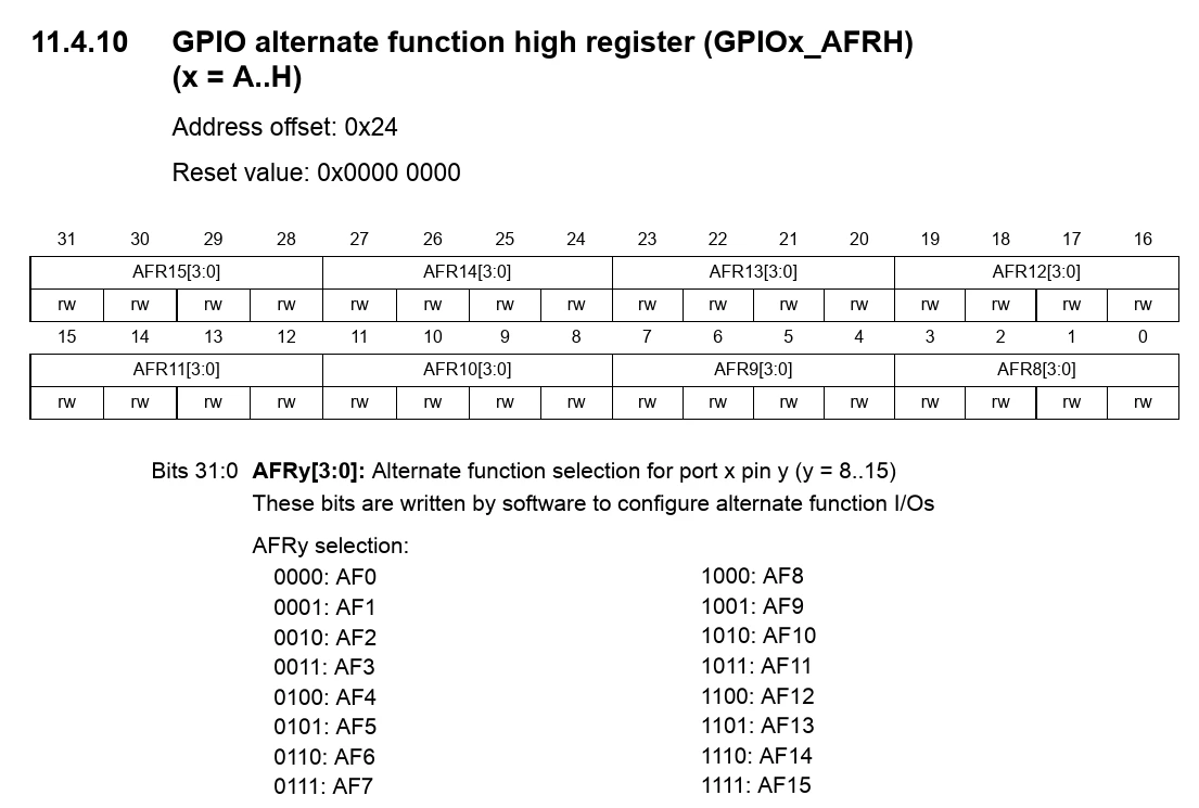

Now try to set "manually" the connection comp6 output on pin PA10 and usart1 rx :
from ds -> af settings:
and sett to port register:
Decide yourself : how to set AFR10 to 7 and 8 at same time ?
So Cube is "right" here, only one position of internal pin mux possible.
And you lost the bet...  :)
