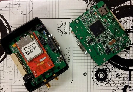

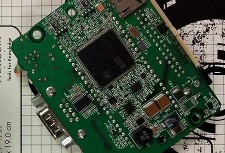

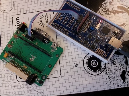

    The transceiver is the NXP TJF1 I don't have a schematic. This is in a Janus Terminus T2 device. The PCLK1 is running at 30Mhz and the HCLK is running at 120Mhz. Here is the initialization procedure for CAN1, which is what I am using:
