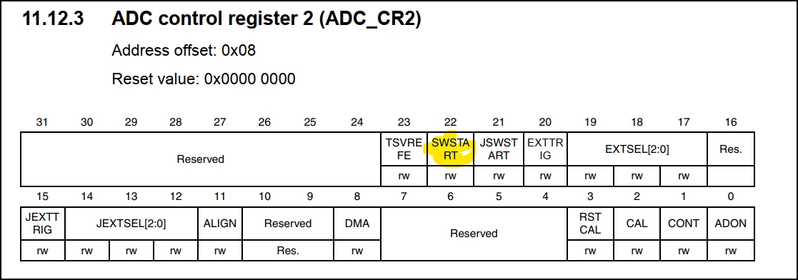

Can not set bit SWSTART to start convert ADC in STM32F103xG

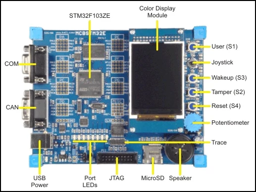

I'm learning STM32 with the board above and trying to program the ADC conversion.
However, when i start debug with keilC and observe the Adc value, nothing happen.
I check the ADC register and realized the SWSTART can not be set to start conversion process.

ADC1->SR &= 0; /* clear the status register */
ADC1->CR2 |= (1<<22); /*start coversion*/

Mar 5, 2024 3:17 PM UTC
ADC_CR2.SWSTART starts conversion only if ADC_CR2.EXTSEL is set to 0b111.
Other remarks:
- you need to perform calibration first, otherwise results will be offset
- ADC_SR is to be cleared by direct assignment of 0, not &=
- sampling time setup is suspicious, I haven't checked which channel is it for but comment says different channel than selected for sequence
