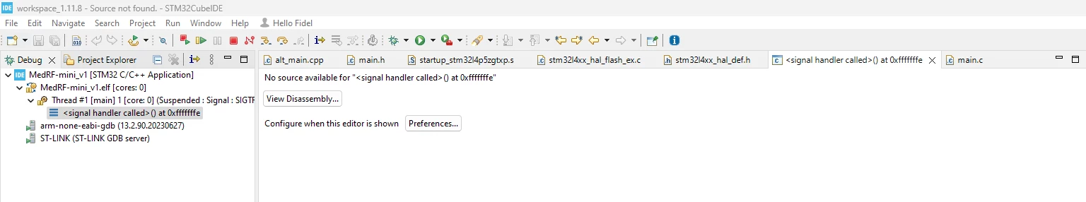

Can not erase flash memory page - a tab pops up when debugging
Hi, i have write a code to erase data of internal flash memory of the MCU. But when i  debug it,a page(tab) pops up with the following message: No source available for "<signal handler called>() at 0xfffffffe" . And i can't any longer debug.
I use the MCU: STM32L4P5ZGTXP_FLASH

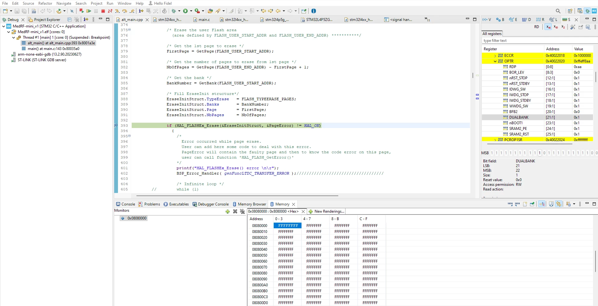

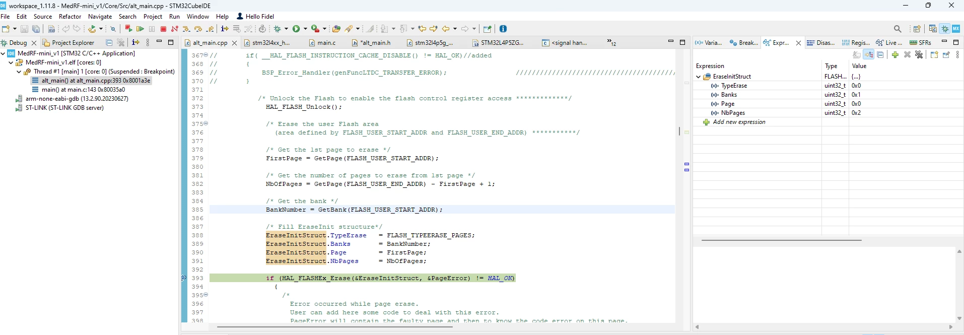

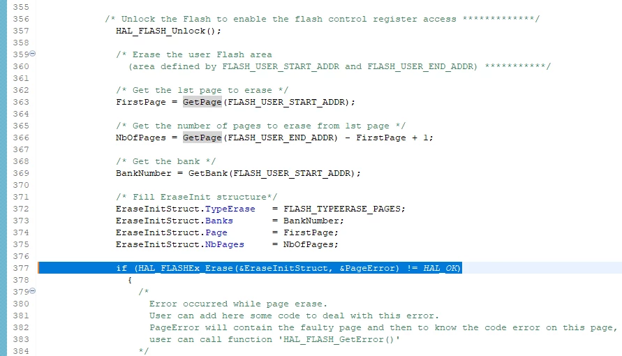

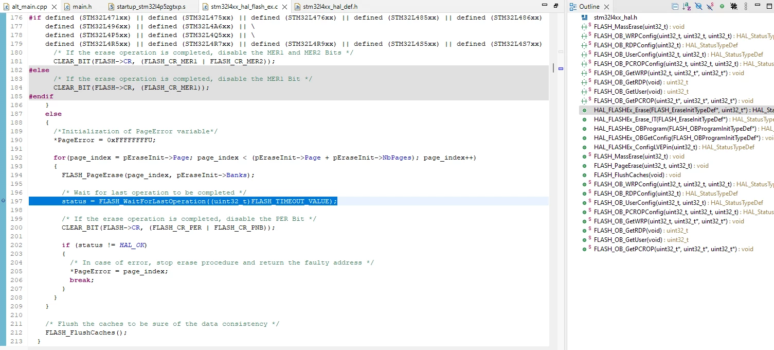

When debugging, the code hangs during execution of the following function:" if (HAL_FLASHEx_Erase(&EraseInitStruct, &PageError) != HAL_OK)", on line 377(see picture below).

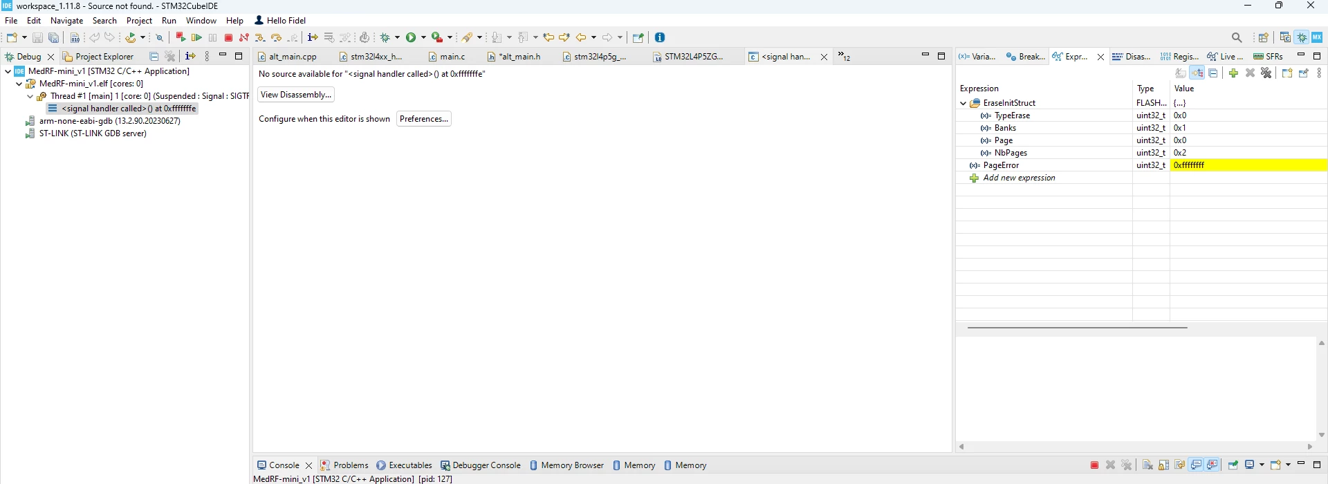

 In function "HAL_StatusTypeDef HAL_FLASHEx_Erase()", the debugging stops(hangs) when trying to execute the code on line 125(see picture below) and the tab mentioned above appears. It even can't enter the function on line 125(function "FLASH_WaitForLastOperation()"). When we are on this function, then press "step into", the tab with the message appears.
The tab with the message that pops-up(appears), see picture below:

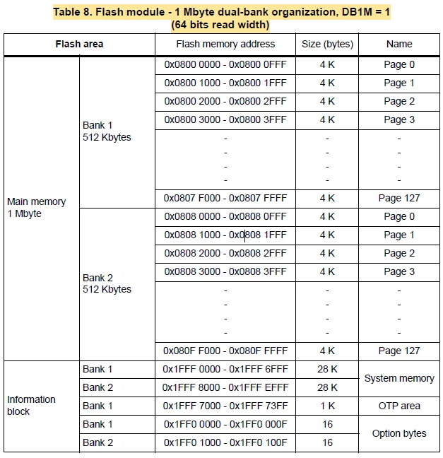

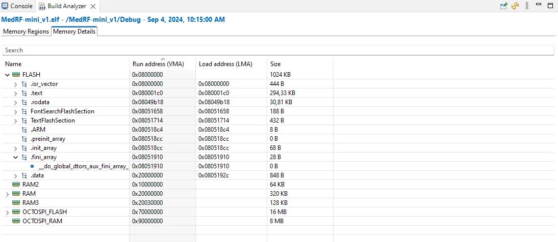

I have chosen pages(adresses) different than the MCU uses. Here below you can see(trough a Build Analyzer picture), wich adresses the MCU uses.
A picture of referance manual below:

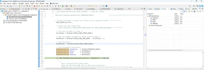

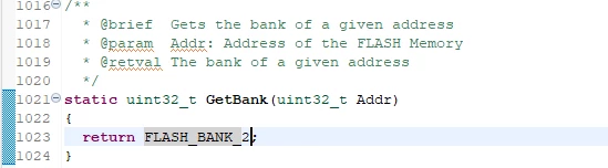

I've found my error. I must correct the return value to FLASH_BANK_2(that's why banks has value 1, since return value is FLASH_BANK_1). Picture below is how it was.
Picture(below) containing the solution(correction):
Thanks SMarie .Thanks guys. Problem solved.

Could you show us the values of EraseInitStruct before you enter HAL_FLASHEx_Erase?
Could you also give us the value of PageError once the function crash?

"Could you show us the values of EraseInitStruct before you enter HAL_FLASHEx_Erase?"
Is it normal that i receive for "Banks" the value 1? Since i use bank2. Or does it refer to number of bank that i use?

PageError value before the crash(see picture below)
PageError value after the crash(see picture below).  I think that it doesn't enter the function  "FLASH_WaitForLastOperation(). PageError has the same value as before the crash.

After the issue happens, connect with STM32CubeProgrammer and verify the correct page was erased.

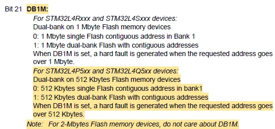

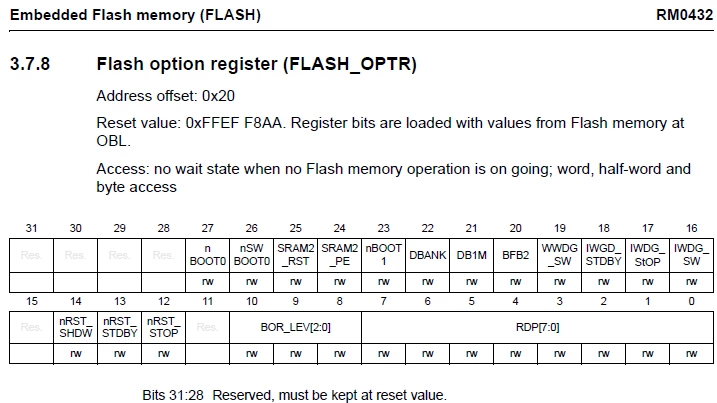

Edit: Also, is the DB1M option byte set? Check with STM32CubeProgrammer. If not, that could be the issue.

DB1M(dualbank) option byte is set, see picture below. I've checked it with "STM32CubeIDE debugger -->SFRs".
All the addresses have the value 0xFFFFFFFF, so it's difficult to check wich page has been erased(see in picture below in memory tab, the value in addresses of the internal flash memory)..
"Can't see your GetPage or GetBank functions."

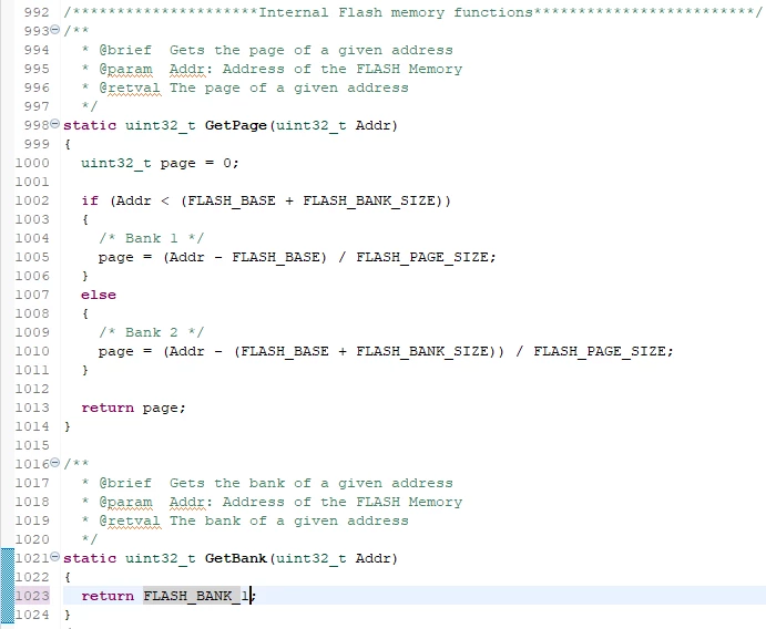

In the code i've posted above it's mentionned. You should click "view more" to see the complete code. It's mentionned on the following lines: 21, 31, 37.

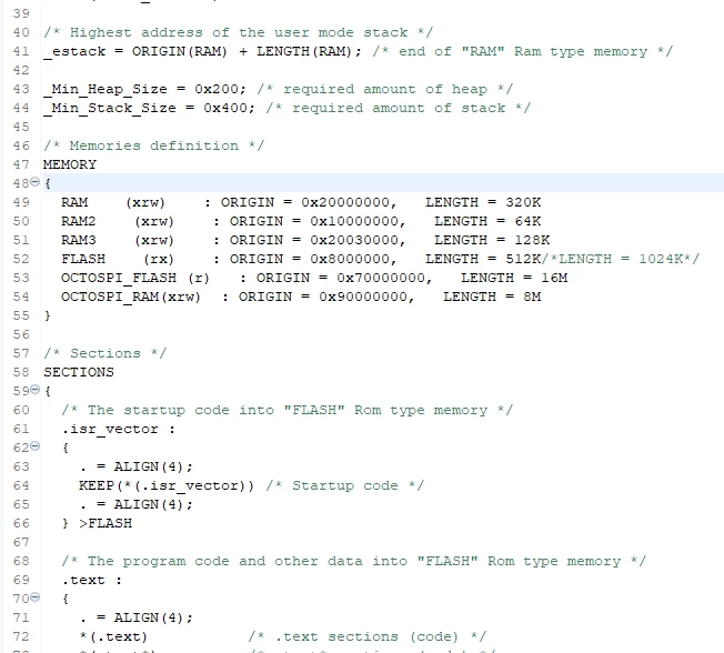

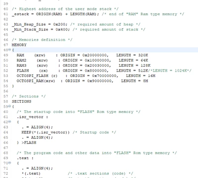

"You should also change linker so that memory at 0x08080000 is not visible to it--change the flash size to 512K"
I've changed it, but still have the same problem. See picture below, for a picture of my linker file.

Erase blocks at the end of memory, not the front / vector table. Basically you're causing an active interrupt to go to 0xFFFFFFFF
Use pages beyond your active firmware image
FLuba.1AuthorBest answer
Senior
Sep 4, 2024 3:19 PM UTC
