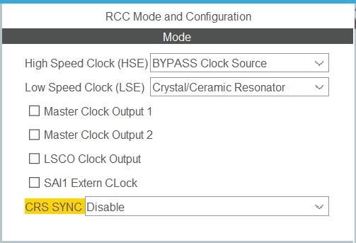

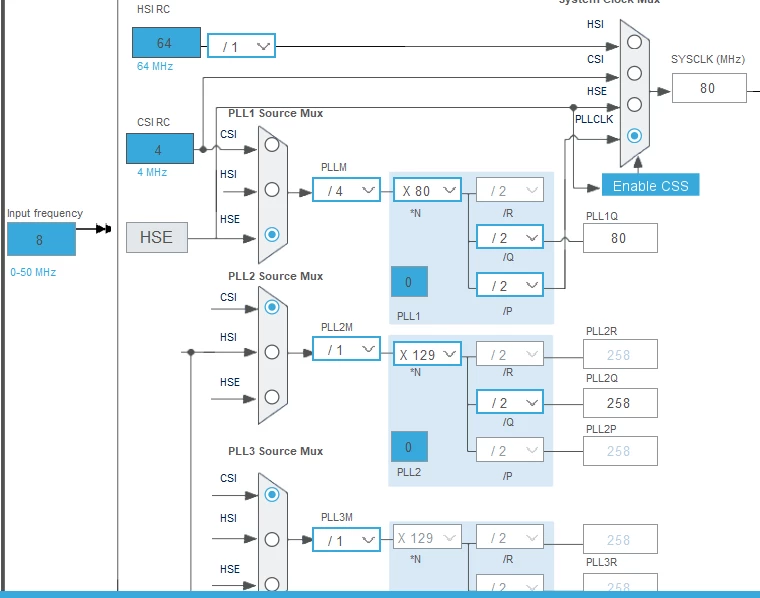

I first worked with CAN with STM32H563 with normal mode. It worked. Later Again I tried it is not working with same code. Loop back mode is working fine. I would like to use other pins for CAN since I am using PD0 and PD1. May I know which pins are good for working with CAN. Please find the attached code and let me know if there any issues in the code.

What clock source are you using for the FDCAN? you need a crystal for CAN communication.

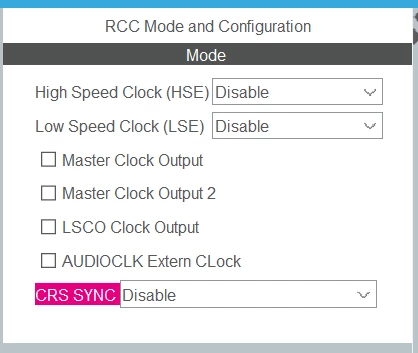

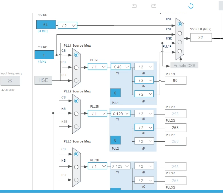

I have tested the same with STM32H533RET the CAN protocol, It worked fine without the external crystal oscillator.
I made the PLL1Q to 80MHz which is the input for the CAN protocol.
Please let me know if i have made any issues with the clock settings.

"I have tested the same with STM32H533RET the CAN protocol, It worked fine without the external crystal oscillator."
-> it can work but it's not recommended for Normal mode. So you need to change the source with a crystal.
