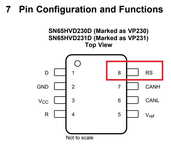

When you are using a chip and you face an issue you need to start with looking at its datasheet as you may find some answers there.
You are using SN65HVD230 transceiver: datasheet at this link: https://www.ti.com/lit/ds/symlink/sn65hvd230.pdf?ts=1703754810632&ref_url=https%253A%252F%252Fwww.google.fr%252F

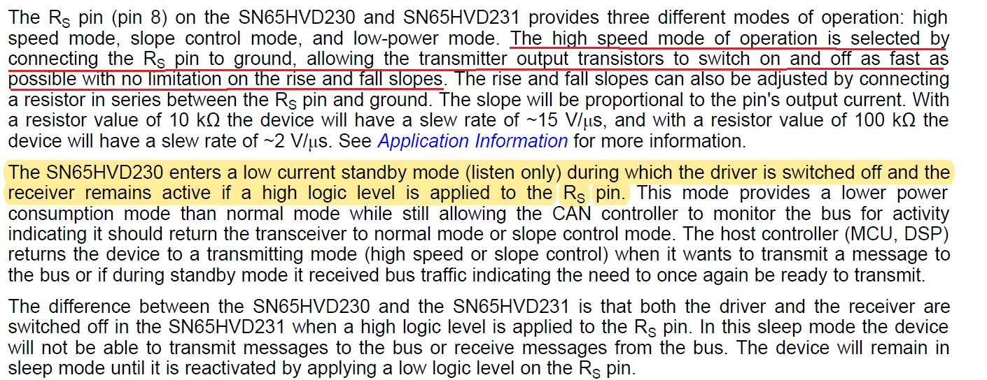

Now, regarding your question about Rs pin. This is it: (look at the datasheet page 5)
This is the Rs pin description in the datasheet:

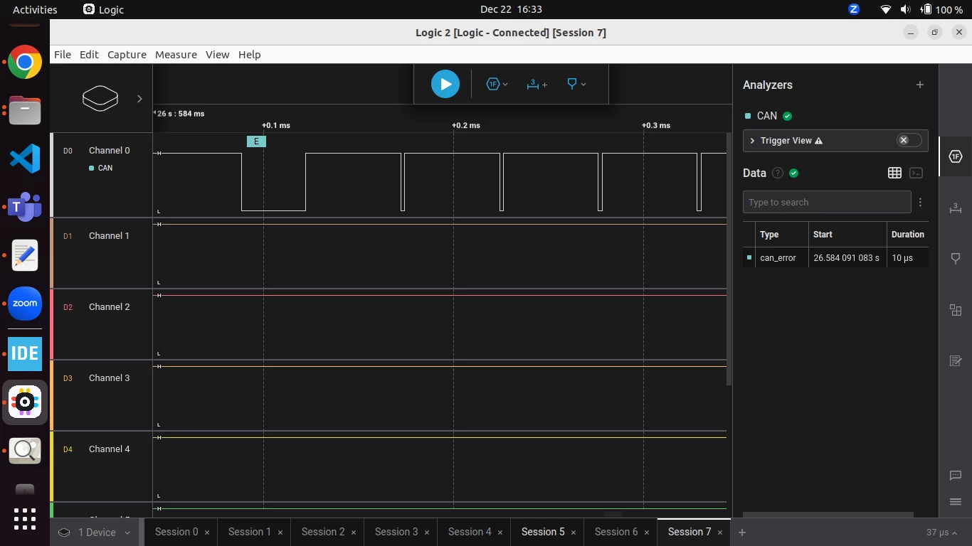

December 27, 2023
NormalModeWaveform.pngThis is the waveforms I am getting by connecting logic analyser on the CAN_Tx pin.

December 27, 2023
My doubt is why am i getting this error for normal mode while its working fine with Loopback mode.

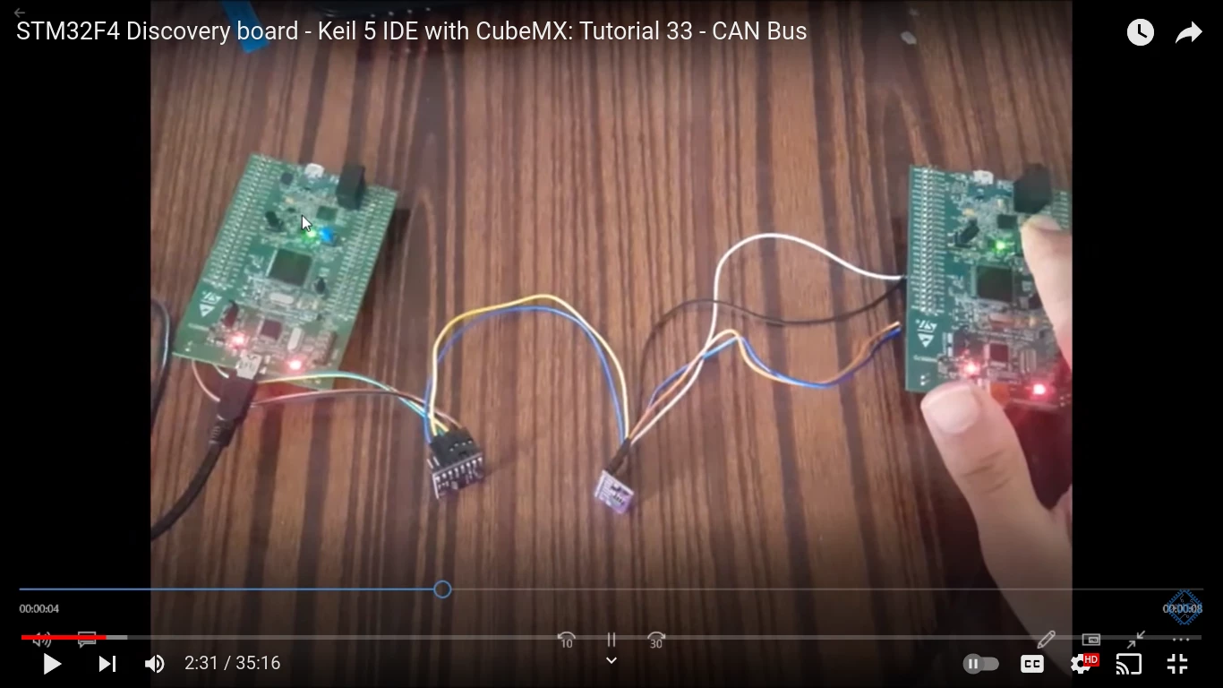

connection.pngI am referring this connection to set up the CAN bus

I am also curious about how its working.I have attached the photo of the transceiver which is bought from amazon I think its the counterfeit one.
mƎALLEm
January 3, 2024
The picture is not sufficient as it des not provide any information. The schematics of the transceiver module is needed.
January 3, 2024
I don't have a reference to any other schematic other than the schematic present in the datasheet by Texas Instrument. I have only one the Texas Instrument datasheet.
