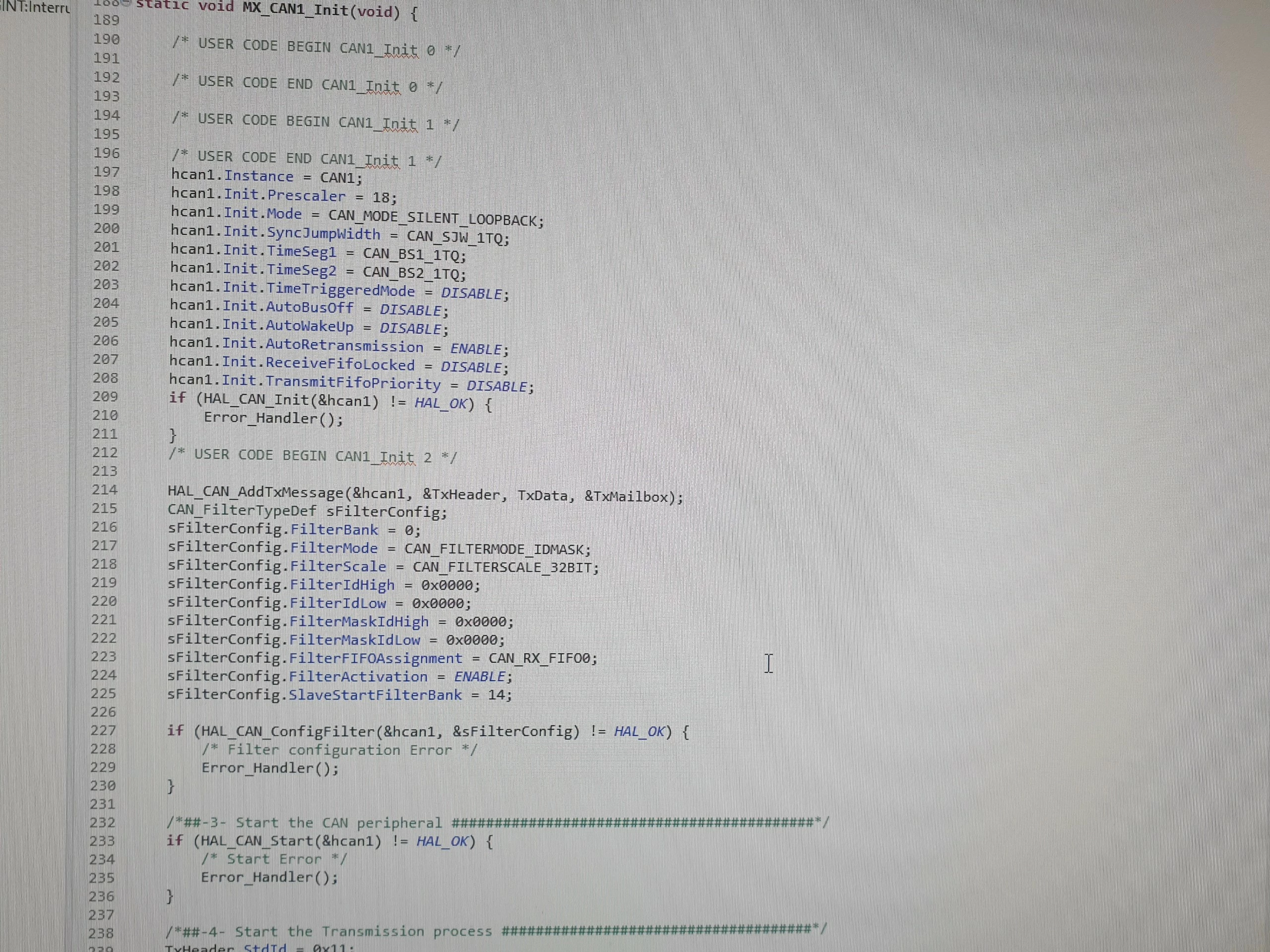

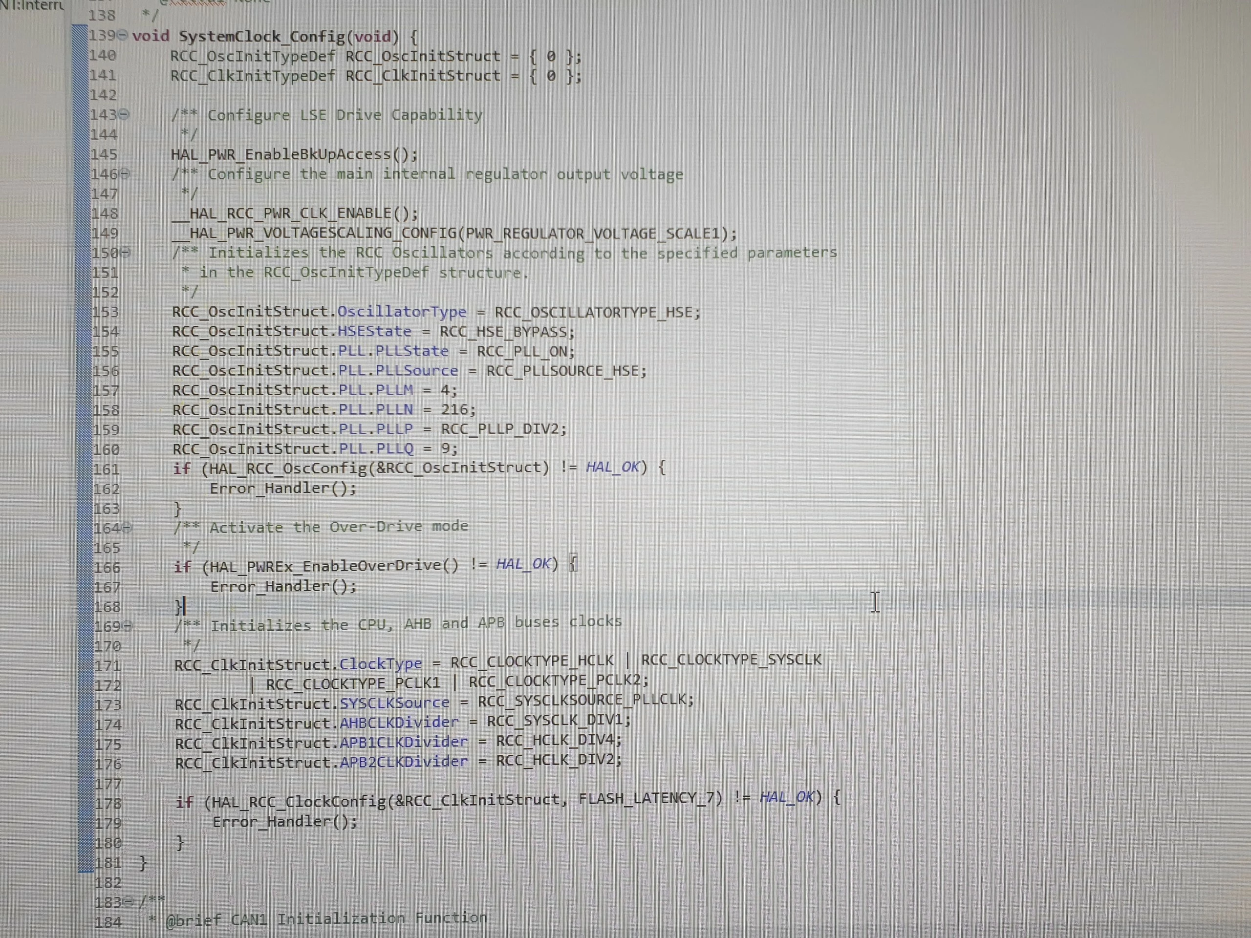

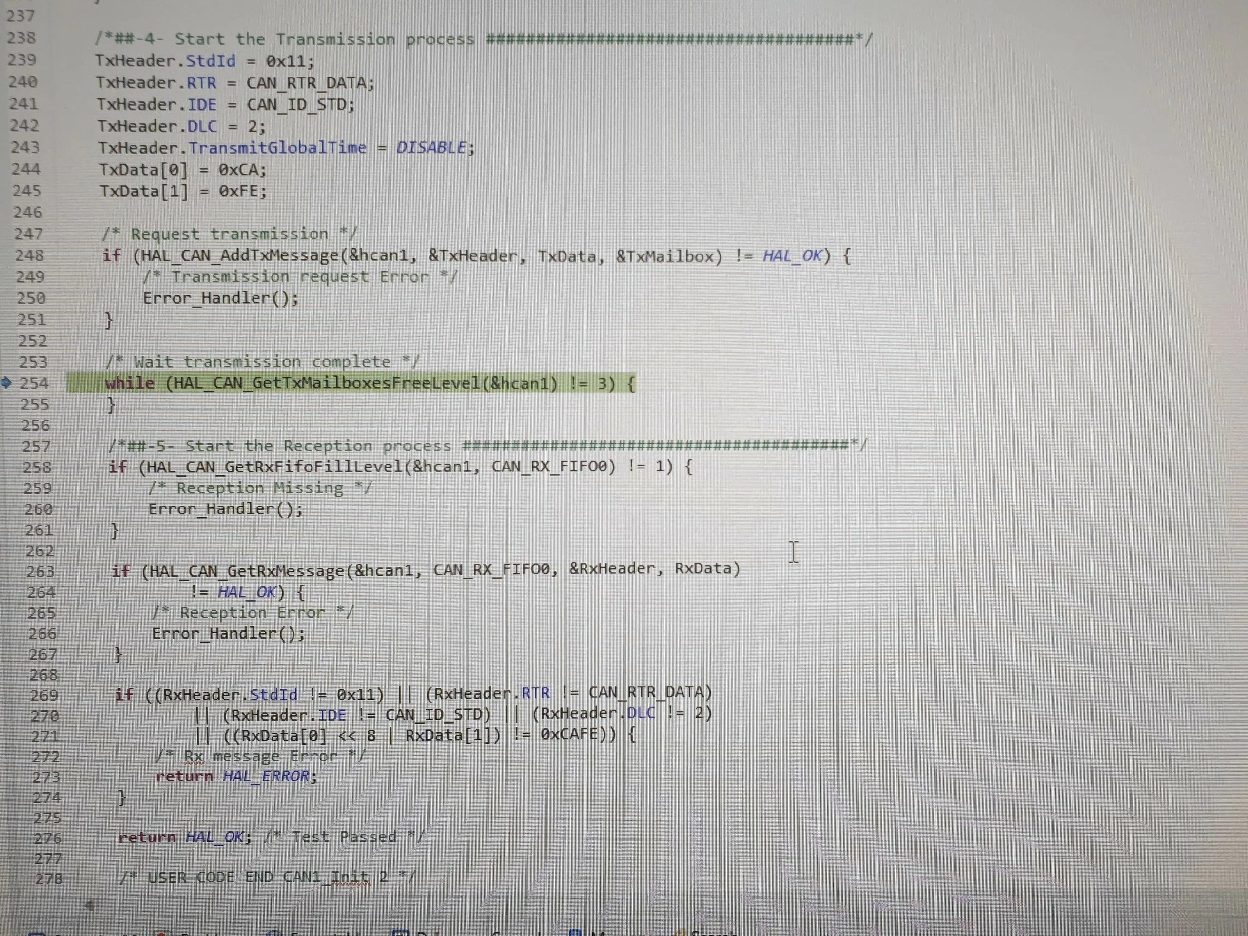

0693W00000KbdYVQAZ.jpg0693W00000KbdYWQAZ.jpg0693W00000KbdgFQAR.jpgI am using the Loopback mode to test the code for CAN module. The pointer is also passed through "HAL_CAN_AddTxMessage(&hcan1, &TxHeader, TxData, &TxMailbox)!= HAL_OK; "
But, the program is looping at "
/* wait transmision complete*/
while(HAL_CAN_GetTxMailboxesFreeLevel(&hcan1)!= 3)
I just use F722ZE Nucleo board, no additional configuration.
I also use STM32 CubeMx to generate the configuration code.
Thank you so much.

I'm wondering why you're using 18 as CAN prescaler and value 1TQ for BS1 and BS2?
Could you please decrease the prescaler and increase BS1 and BS2 to match your bitrate, then test again?
