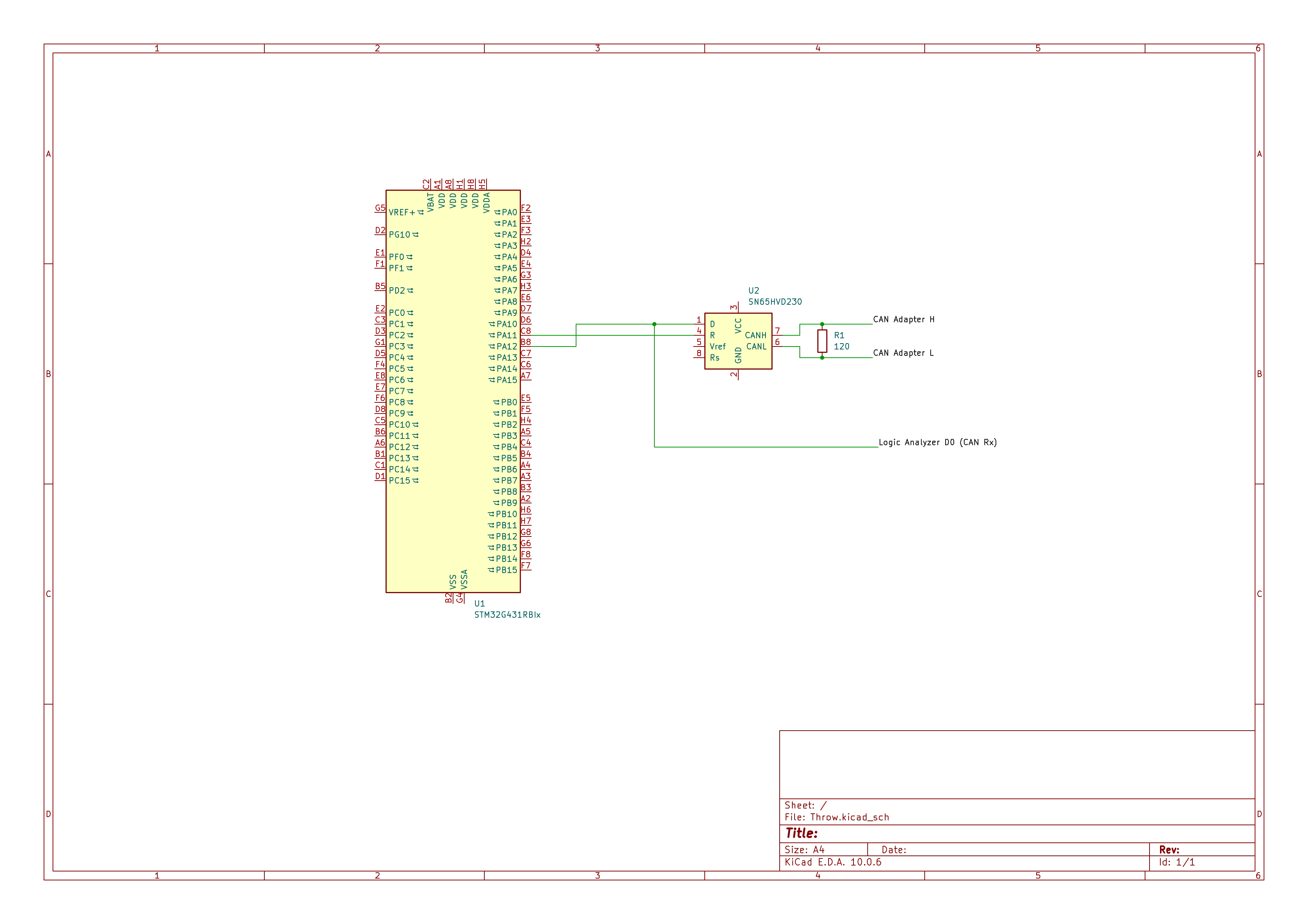

Hello, hope you all are doing well.
I am unable to transmit messages over CAN using DMA on my STM32G431RB Nucleo board. My JLink didn’t show any errors in my code flow, but my logic analyzer did not register any CAN messages on the TX pin (PA12), and the output stays high. I also tried using a CAN adapter to read the messages which wasn’t fruitful. How can I debug this? I used this tutorial for reference:
Thank you in advance!

jjohnAuthor
Sep 18, 2026 4:09 PM UTC
Hello, mƎALLEm, thank you!
I looked at the definition of HAL_FDCAN_AddMessageToTxFifoQ and saw that it was copying the message to RAM which I thought was using DMA internally, but it looks I am mistaken about the concept, sorry about that.
Yes, I meant that I debugged the code using JLink and GDB, and saw that HAL_FDCAN_AddMessageToTxFifoQ was copying the message to RAM and returning HAL_OK.
Yes, I will try the external loop back mode as well and report back.
This is a simple schematic of my connections. Assume all the power and ground pins are connected. I am using an STM32G431RB Nucleo board with a Waveshare SN65HVD230 CAN module
mƎALLEm
Sep 18, 2026 4:21 PM UTC
You have an issue with the transceiver:
Based on the schematics, RS pin is kept floating and it’s internally pulled-up. I don’t know about that Waveshare module and how that RS is connected.
The RS pin should be connected to the ground.
According to the datasheet, when Rs is pulled up it puts the transceiver in low power mode.
But need to test the External loopback mode.
