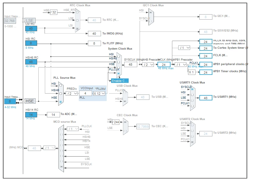

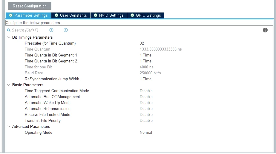

Hi, I am using the following:
cubeIDE 1.13.1/STM32F072C8U6/baud = 250K - I attached a picture of my clock diagram & param setup.
I do not see messages sending on the CAN bus. They worked fine in my previous IDE. I have a feeling it has to due with the time quanta but not 100% sure. I tried adjusting to quanta 10/5 after reading the following with no luck:

Init:
static void MX_CAN_Init(void)
/* USER CODE BEGIN CAN_Init 0 */
/* USER CODE END CAN_Init 0 */
/* USER CODE BEGIN CAN_Init 1 */
/* USER CODE END CAN_Init 1 */
hcan.Instance = CAN;
hcan.Init.Prescaler = 32;
hcan.Init.Mode = CAN_MODE_NORMAL;
hcan.Init.SyncJumpWidth = CAN_SJW_1TQ;
hcan.Init.TimeSeg1 = CAN_BS1_1TQ;
hcan.Init.TimeSeg2 = CAN_BS2_1TQ;

These definitely are bad time quanta values to define the bit time:
BS1 = BS2 = 1 x tq !!
You need to increase as much as possible  BS1 and BS2 while decreasing the prescaler. You need to take care about the sample point that needs to be at around 87,5%.
Please refer to this article:
Indeed, the link  http://www.bittiming.can-wiki.info/  is recommended for the bxCAN bit time computation so if you’ve used 10/5 proportions for the bit time you need to ensure the updated CAN bitrate is inline with the CAN bus one as the config is in Normal mode.
You can also do a test with the loopback mode and monitor the CAN_Tx pin.
