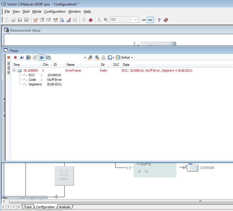

Hello all,
I wrote code for CAN message transmission using STM32F429ZI board. Message is not getting transferred. It is displaying only error frames in CANanalyzer. Please suggest me solution for this problem. I have attached the code for your convenience. Even I have attached a snapshot of CAN analyzer result.
Thanking you.

Since it appears to be a bus issue you have to look at both nodes.  What are you using as the second node (CAN requires a minimum of 2 nodes to work), and does the other node show bus errors?   Look at the CAN_ESR register on the 'F429, what does it tell you?  Are you getting bus errors before you even try to transmit?

Dear peacock.jack.003,
Here I am attaching CAN_ESR status image. I am stuck in this since 5 days. Still I am unable to solve the issue.

The ESR shows a high number of TX errors (TEC = 251) due to bit dominant errors (LEC = 5).  Typically this is the signature of a bus with only one node attached.  Do you have two nodes on the bus and is the cable terminated at both ends?  Do both nodes restart at the same time?
Your transmit fails because the bus has disconnected (BOFF asserted) due to excessive errors.  This is a requirement for CAN bus in order to prevent a failed node from flooding the bus with bad messages.
Check your other node to see if it has the same errors.  One of the complications of CAN when bringing up the first two nodes is avoiding a race condition where the first node sees no other node and disconnects, then the second node does the same when it starts because the first node is disconnected.  You need several retries on both nodes to ensure you hit a window where both nodes are connected in order to establish a working network.
After the first two are running additional nodes aren't a problem because a working bus has been established.  Additional nodes will always see a bit dominant before transmitting.
The way I handle this is to set up a retry timer after a BOFF bus disconnect event.  The node logically disconnects, waits for the timer, then connects and attempts to transmit again.  The retry delay is shorter than the time to reach the TEC cutoff point where the bus disconnects.  This ensures an overlapping window with two nodes using the same retry algorithm.  Sorry, no code, I don't own it.
If your second node is something other than another STM32 then you will have to figure out how that device handles bus retries (not a simple task) and implement the same strategy on the 'F429.
