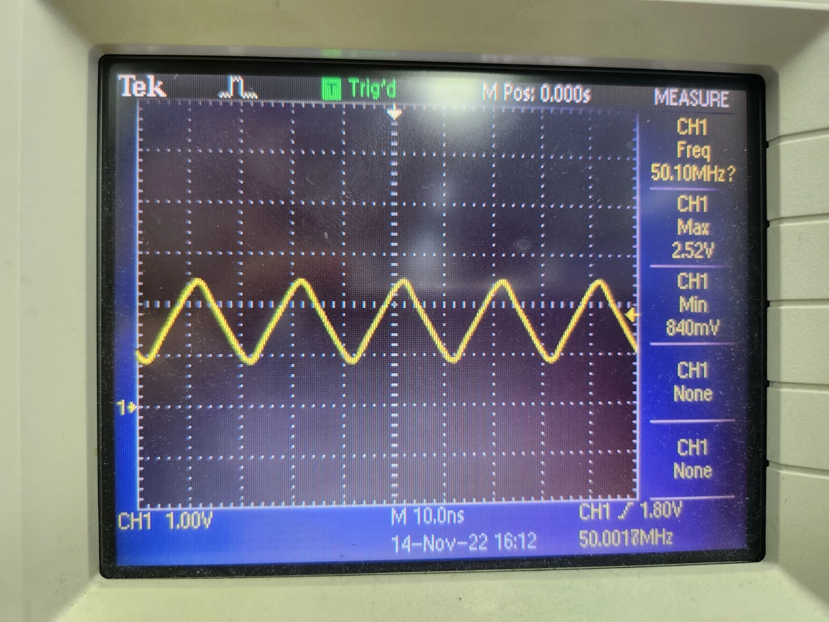

Can make a 50MHz PWM output?
MCU : STM32H7, PB0 ​PWM CH2N
TIM1 CLK : 200MHz
Prescaler : 0
Counter Period : 3
Pulse : 2
GPIO Speed : Very High​
I'm testing a 50MHz PWM output.
And my test conditions are written at the top of this question.
As a result, I decided that a 50MHz PWM output was impossible.
This is because the square wave is distorted by the slew rate as shown in the attached picture.
However, the output buffer timing characteristics of the datasheet states that frequencies up to 220 MHz are possible.
So I leave a question to ask if I've missed anything.
thank you
are you just toggling a GPIO or using a proper PWM timer?
What about unwanted capacitances? show us your hardware

jhwan.2
jhwan.2Author
November 14, 2022
hi. Javier
I use TIM1 for PWM CH2N.
Nothing is connected to the PWM output.
I'm just checking the waveform with an oscilloscope.
Javier1
Principal
November 14, 2022
you think nothing is connected to the pwm output.
Are you usign your own custom board or any nucleo/discovery boards?
Because nucleo and discovery boards have lots of caps and external components
hit me up in https://www.linkedin.com/in/javiermuñoz/
QSHAO.1
November 14, 2022
the capacitance load on PB0 may be a reason of longer rising time of PMW signal, so you may check this point firstly. ​

... and as your oscilloscope looks exactly like my Tektronix with only 100 MHz Bandwidth:
to check a 50 MHz square wave, you will need much higher bandwidth.
Not to forget the probe, and how it is connected to the test point - mind the GND connection, which should not run over a few inches of extra cable.

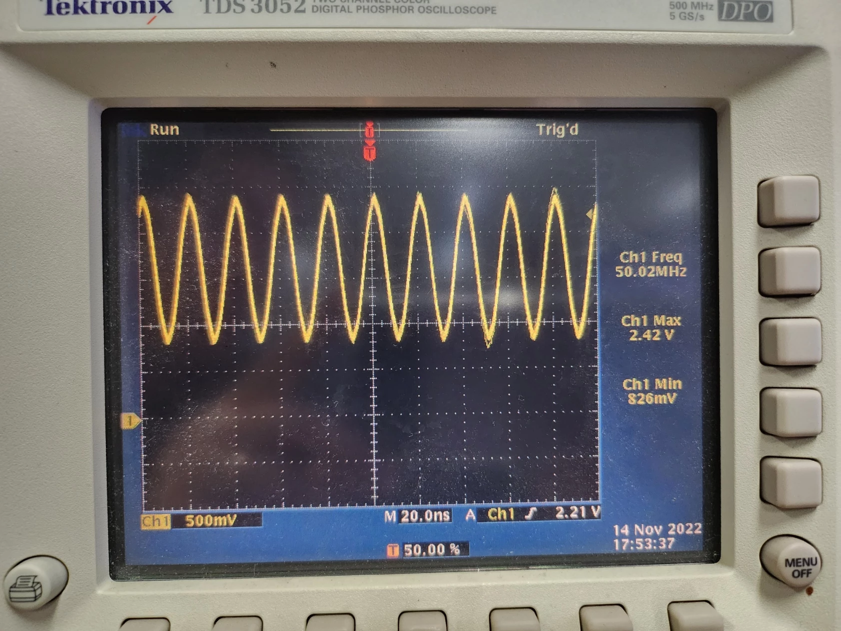

jhwan.2
jhwan.2Author
November 14, 2022
LCE
Principal III
November 14, 2022
Nice, okay, I oversaw the 500 MHz!
Still, you can do a lot of things wrong with the probe.

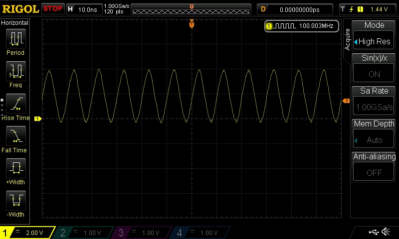

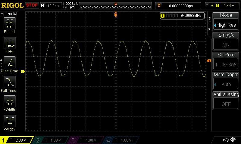

AScha.3
November 14, 2022
and probe is 10:1 ? how many Pf input ? min. 200 MHz type?
+ square wave is adjusted ?
64Mhz out on MCO1, with my DSO, and with 100MHz probe (so no square possible, just similar sine wave):
0693W00000WIJHZQA5.png and 100Mhz , 4Vss ...

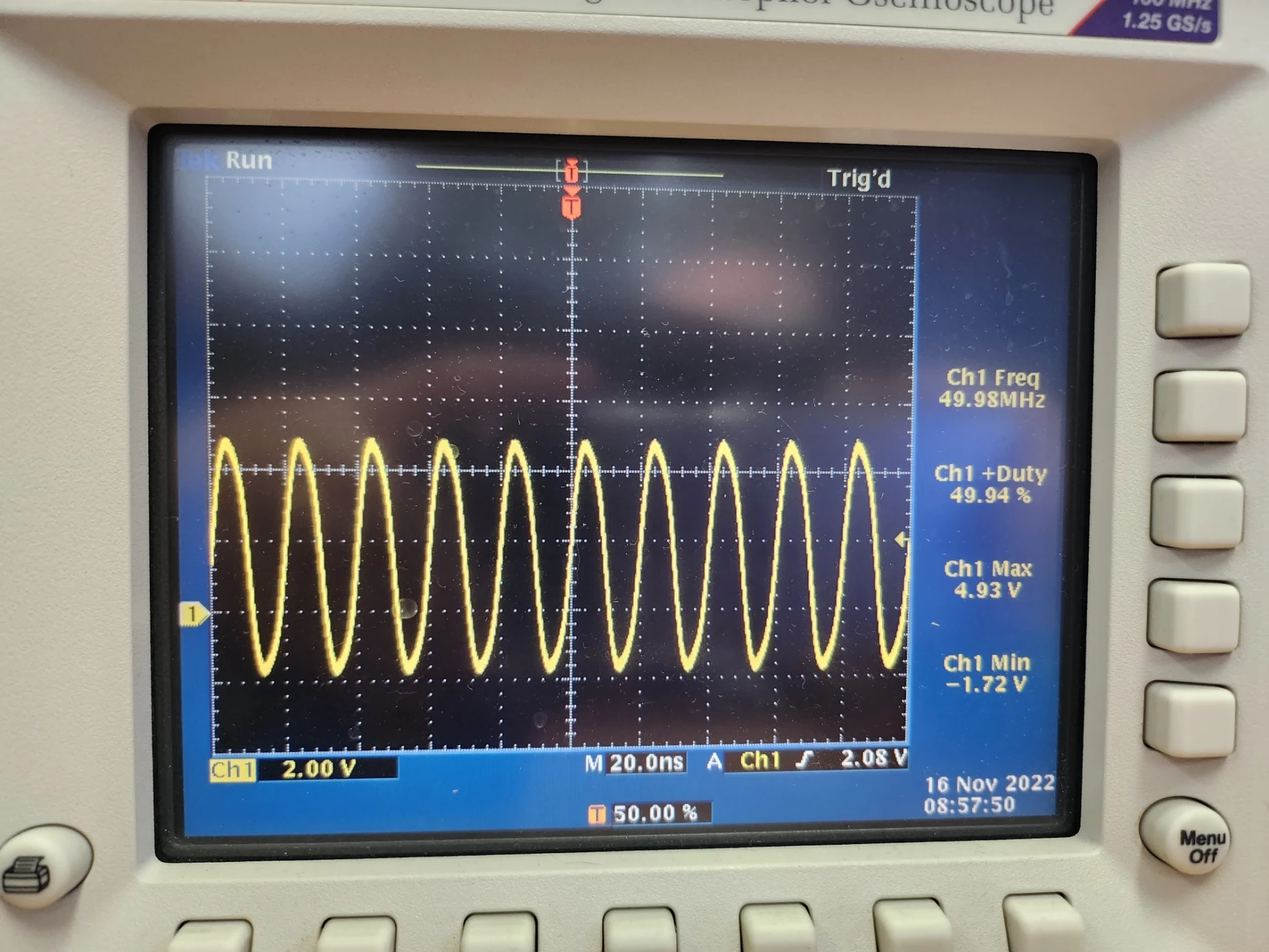

jhwan.2
jhwan.2Author
November 16, 2022
The problem has been resolved.
Probe setup was the problem.
After setting to x10 mode, the waveform was checked normally.
