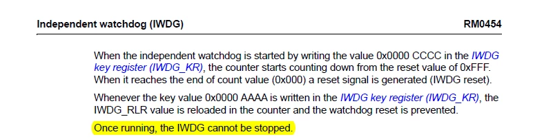

Can LSI oscillator be disabled once the IWDG has started running on STM32G0 ?
In my application I have configured IWDG to start running.
I would like to prevent the IWDG from resetting the MCU while in stop 1 mode for extended period of time.
In the reference manual it says: "Once running, the IWDG cannot be stopped."0693W00000QL7NIQA1.png

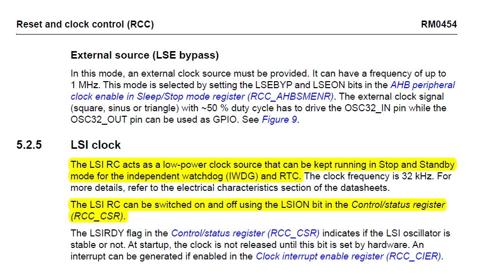

But in the RCC section of the manual it says
"The LSI RC can be switched on and off using the LSION bit in the Control/status register (RCC_CSR)."
This would lead me to believe that its possible to turn off the LSI clock after the IWDG has been enabled.
If I try to turn off the LSI clock before entering Stop 1 mode, the MCU ends up being reset by the IWDG.
Is it true that LSI cannot be stopped ig IWDG has been engaged?

Correct, LSI cannot be stopped when the IWDG has been activated. This is also mentioned in RM0454, section 5.2.13:
If the Independent watchdog (IWDG) is started by either hardware option or software access, the LSI oscillator is forced ON and cannot be disabled.

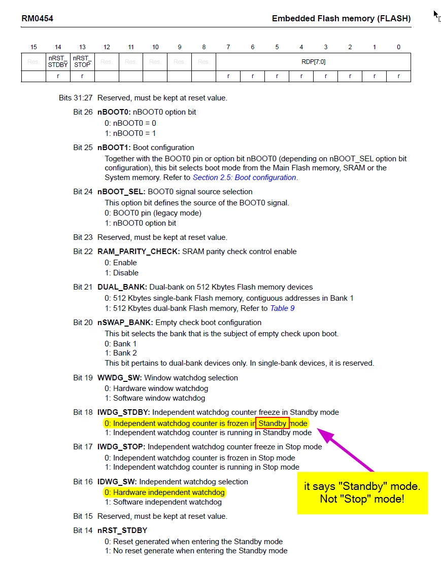

There is no option byte to disable IWDG in Stop mode.
There is, however, and option byte to disable IWDB in Standby mode. I can confirm that in my application when I enter Standby mode that IWDG does not reset the MCU.
See page 65 of RM0454:
Bit 17 IWDG_STOP right between your yellow markers is literally that.

You right!
Tom MacDonald
July 20, 2022
@Peter BENSCH​
Does that mean I can stop the IWDG from restarting my app if I go into stop mode and wait for interrupt (potentially indefinitely?) provided that I set the bit 17 to 0?

It should be like that, but other people have problems. Could be related to the WB/WL parts with radio.
