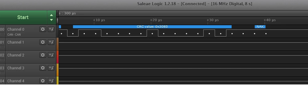

I am using CAN1 in loopback mode and when i probed CAN1_TX, i found NAK. why is that ?
wont the same can1 controller ack it ?
if NAK then CAN1 should re transmit the frame ( NART is 0) , but dont see any retransmission
trace is shown , Thanks.

    did you pull up the Rx pin ?
    enable ABOM
