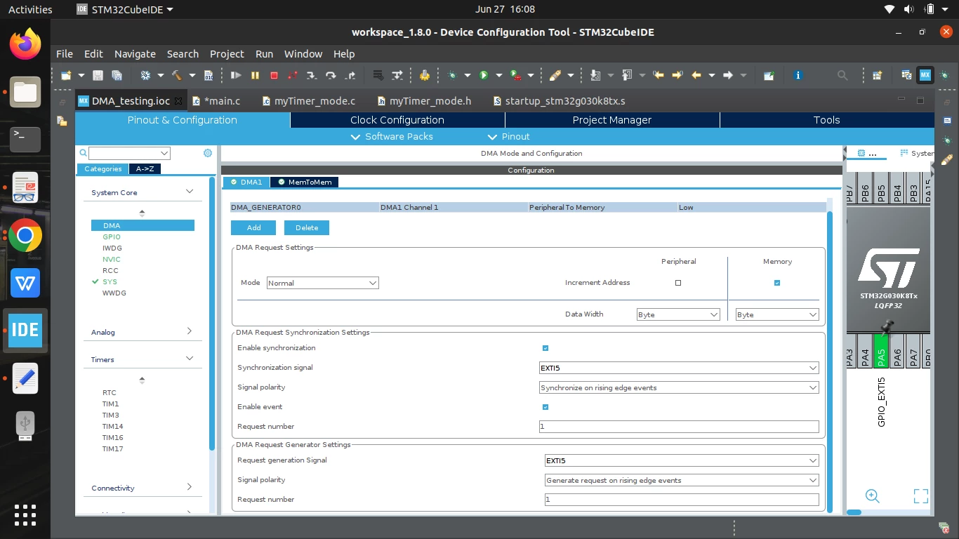

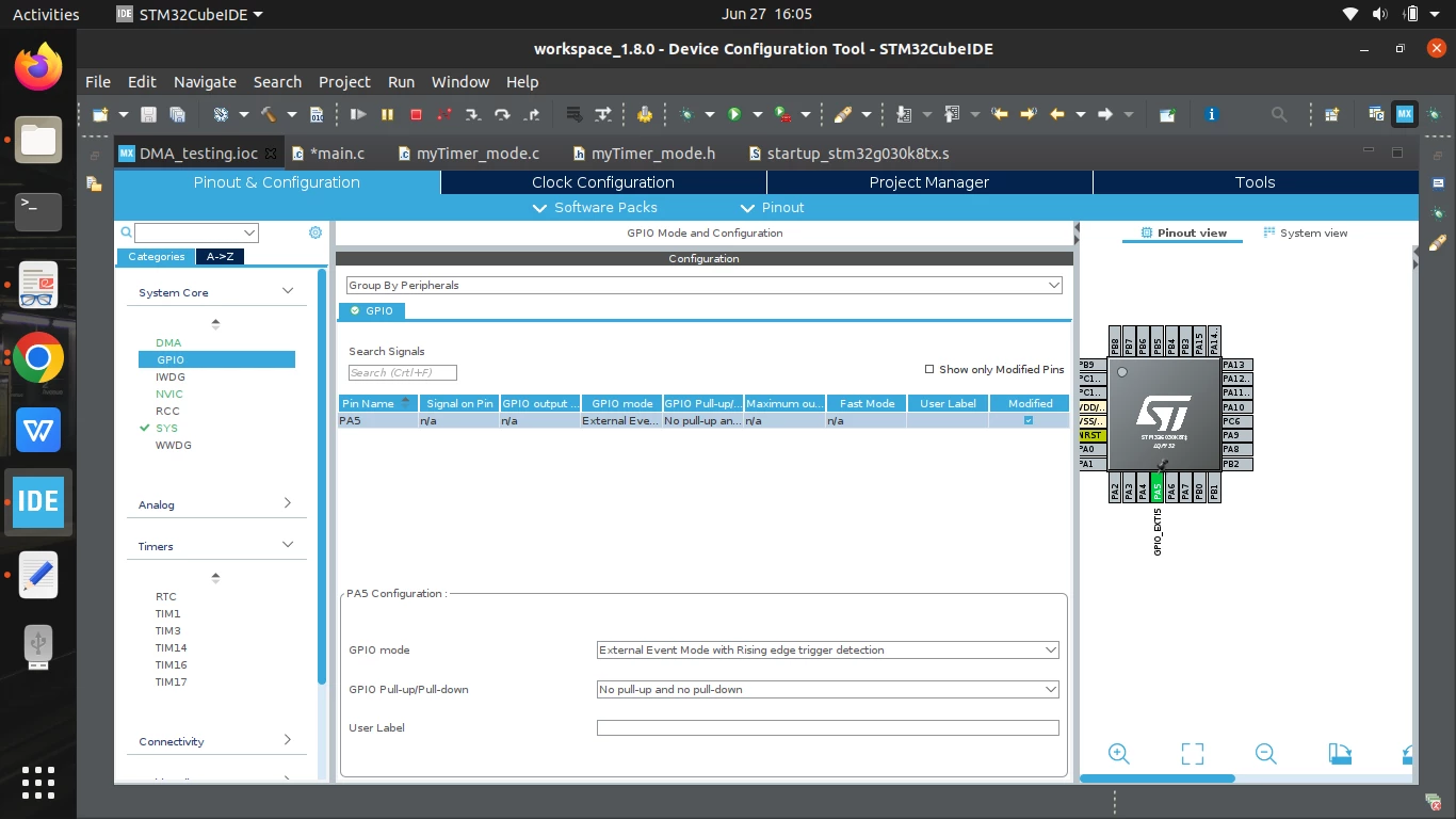

First i have set that particular pin to GPIO_EXTI pin and set it as in rising edge.
0693W00000Nso6JQAR.pngSecond I've request a DMA on that pin.
0693W00000Nso7WQAR.pngBut i Don't know what should i do next? Should i just start the dma in interrupt mode or what( HAL_DMA_Start_IT(hdma, SrcAddress, DstAddress, DataLength)).
waclawek.jan
June 27, 2022
Which STM32?
In older STM32, there was no other way than to use timer pin.
In newer STM32 with DMAMUX, there may be DMAMUX inputs connected to EXTI lines. Read the DMAMUX chapter in RM. I don't have first-hand experience with these.
I don't know if this can be clicked in CubeMX, I don't use Cube.
