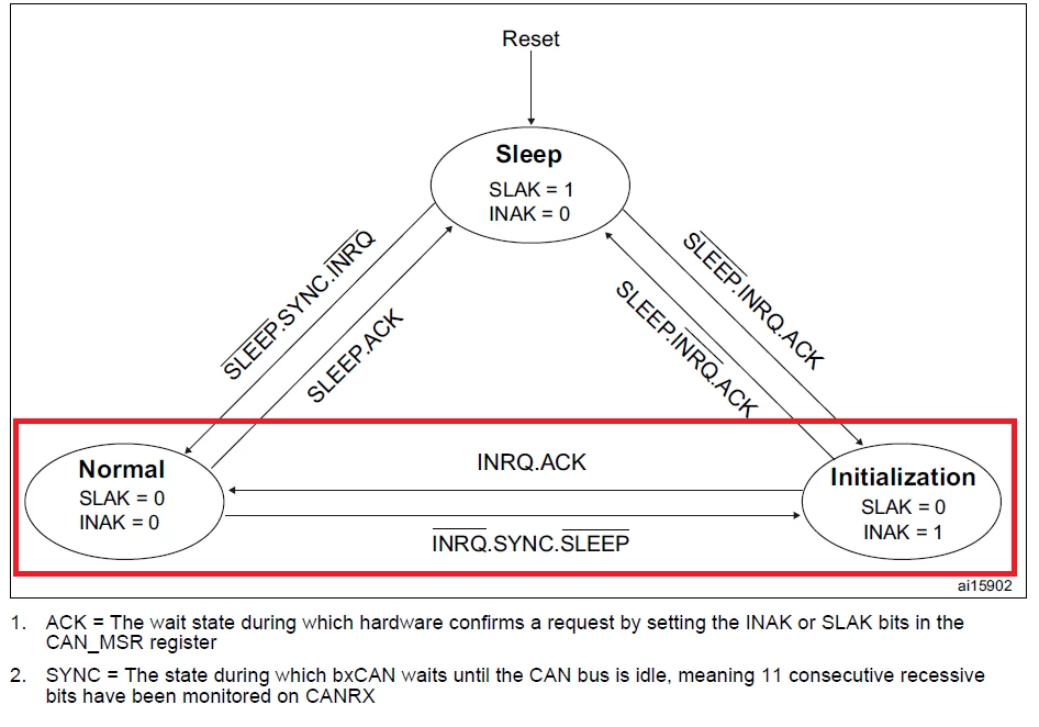

I am working on CAN Communication in F103
When I am de-initializing properly , But when , I am reinitializing it is not working
Please tell me how to reinitialize CAN Communication

To go from Normal mode to init mode or vice versa you need to check this figure in the reference manual:
Your node needs to detect 11 consecutive recessive bits on the bus otherwise it keeps blocked mainly if the bus is overloaded.
