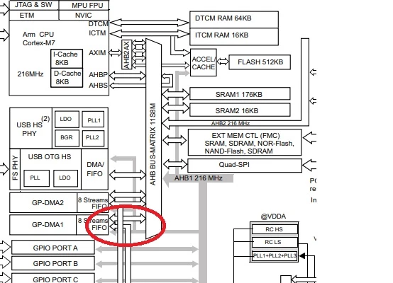

Can I use DMA1 in Memory-to-peripheral mode to transfer a data over USART2?
  • December 18, 2022
  • 4 replies
  • 997 views
I'm lerning Cortex-M7 (stm32f722) and I don't fully understand how DMA1 works. On the one side DMA1 not connected with AHB therefore PORTs and SRAM not available. On the other side in datasheet didn't type that Peripheral-to-memory and Memory-to-peripheral modes not available for DMA1. Can I use DMA1 in Memory-to-peripheral mode that transfer a data over USART2? Thanks!

    ABart.1
    ABart.1Author
    December 18, 2022
    But SRAM connected to AHB BUS. And DMA1 not available AHB BUS. Or I don't right?0693W00000WLFi8QAH.jpg
    Piranha
    Principal III
    December 18, 2022
    The place, you encircled, literally shows that the DMA1 is also connected to the same AHB bus matrix.

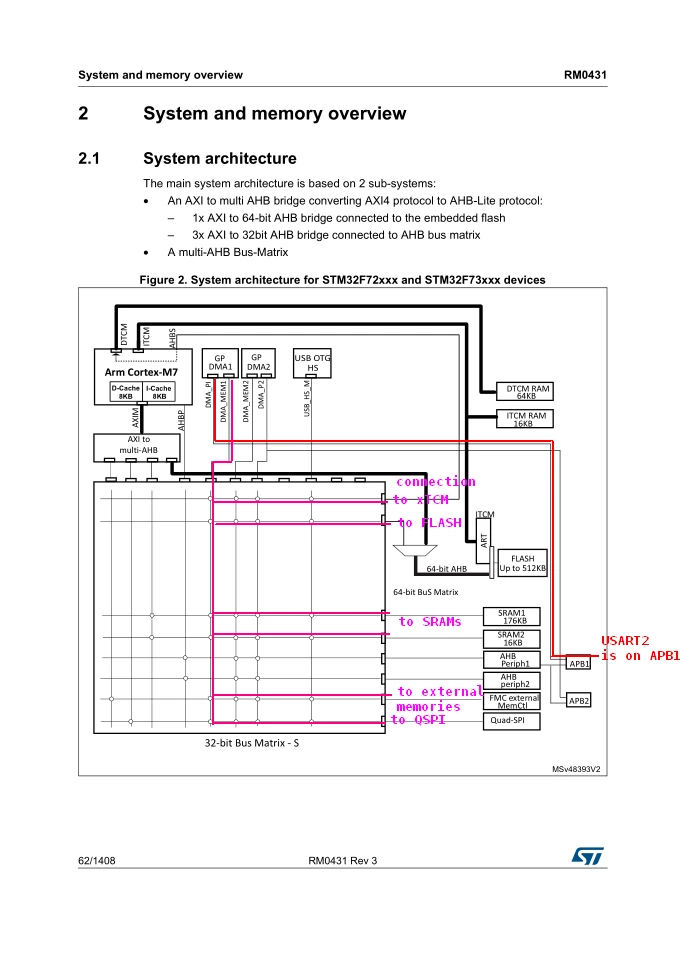

    waclawek.jan
    December 18, 2022
    Yes you can use DMA1 to access USART2, which is on APB1:
    0693W00000WLFoLQAX.pngJW
