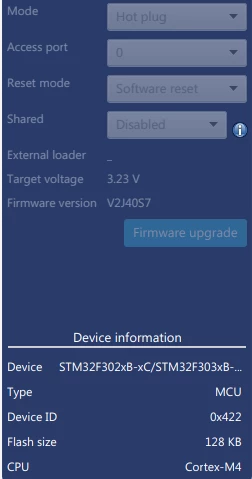

I have successfully flashed my BluePill Board with an STM32F103 chip using the STLINK interface of a Nucleo board. Now, I have replaced the chip with an STM32F302CBT6 and am trying to flash it. However, I get the error message 'Target no device found. Error in initializing ST-LINK device. Reason: No device found on target.' when attempting to flash the new chip. What can I do to flash the new chip successfully? Are there specific changes to the hardware or software that I need to make to support the new chip?

I have now replaced the 302 chip with the 103 chip again. The 103 chip can be flashed without any problems. However, when I solder the 302 chip back on, flashing is not possible. I have checked each solder joint under the microscope twice.

I am using the Cube IDE. However, I am unable to connect to it. Even with the ST-Link utility, I am unable to establish a connection.

I have gone through the document and I believe that it should work. Now, I have installed another new 302 with the same result. Is there a country restriction or something like that? I purchased the controllers from Mouser.

Yesterday, I received three pieces of STM32F303. Full of anticipation, I soldered one chip and tested it. Unfortunately, the result did not change. Still the same error message. After spending the night on the internet trying to find a solution, I soldered another chip onto my custom PCB, but it didn't change anything. During one attempt, I was holding the PCB in my hand and accidentally touched the SWDIO, SWDCLK, V+ and V- pins that connect the custom PCB to the Nucleo board. Suddenly, the chip was programmable. It seems that I'm missing pull-ups.
