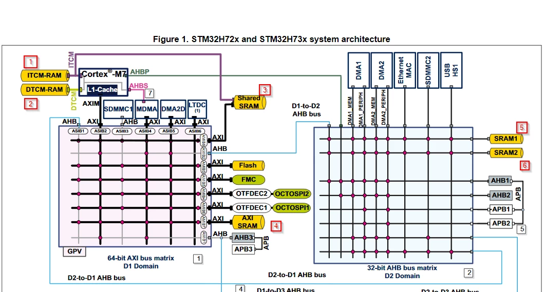

Hi @F.Belaid​
I measure performance by toggling io pins and view/compare/measure with an oscilloscope.
0693W00000Y9p80QAB.pngReading AN4891, I want to know how the address space is split up from the defines in the linker file. (I am referring to the numbers I put in the screenshot)
In the linker file these regions are defined
/* Specify the memory areas */
MEMORY
 ITCMRAM (xrw)   : ORIGIN = 0x00000000,  LENGTH = 64K
 DTCMRAM (xrw)   : ORIGIN = 0x20000000,  LENGTH = 128K
 FLASH   (rx)   : ORIGIN = 0x08000000,  LENGTH = 1024K
 RAM_D1 (xrw)   : ORIGIN = 0x24000000,  LENGTH = 320K
 RAM_D2 (xrw)   : ORIGIN = 0x30000000,  LENGTH = 32K
 RAM_D3 (xrw)   : ORIGIN = 0x38000000,  LENGTH = 16K
It is clear that ITCMRAM and DTCMRAM are 1) and 2)
But RAM D1, is that 3) and 4) or just 4)
And RAM D2, is that 5) and 6)
If I interpret the information from AN4891 correctly, I will get best performance by using ITCMRAM for code, DTCMRAM for lookup tables and AXI RAM for calculation variables. Hence my question about addressing, how do I specify variables to be located in AXI RAM?
And to come back to a previous post, if I were to use the DTCM caching and want to configure the MPU, is the code I posted correct? And if I want to split DTCM into a part that is cached and part that is not, do I then specify e.g. MPU_REGION_SIZE_64KB?
And do I then split DTCMRAM in the linker file into 2 regions?
