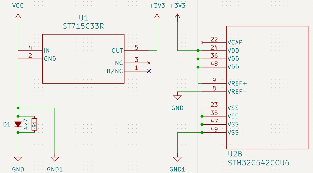

Is it possible to pull Vref- lower then Vss? For reverse voltage protrection I use a diode and a resistor to create GND1. GND1 is then connected to VSS of the µC.
Scematic. All caps omitted
Can I connect Vref- to GND? See Image.
Datasheet stm32c542cc
The datasheet does not specify.
If I connect Vref- to GND1 all values i measure with the ADC must be against GND1 otherwise the result is off by the offset of GND1 to GND.

No. VSSA = VSS.

Probably not.

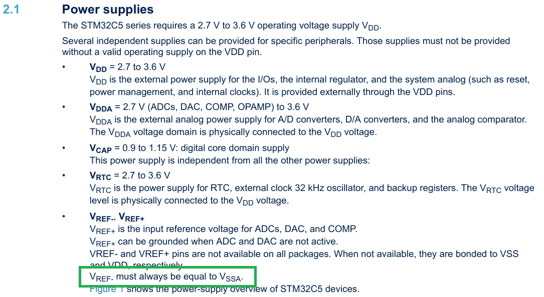

The C562 datasheet makes it look like Vref- = GND:

BTW, make sure you connect VCAP, check the datasheet.

No. VSSA = VSS.

2.1 of the application note 6274 is even more clear.

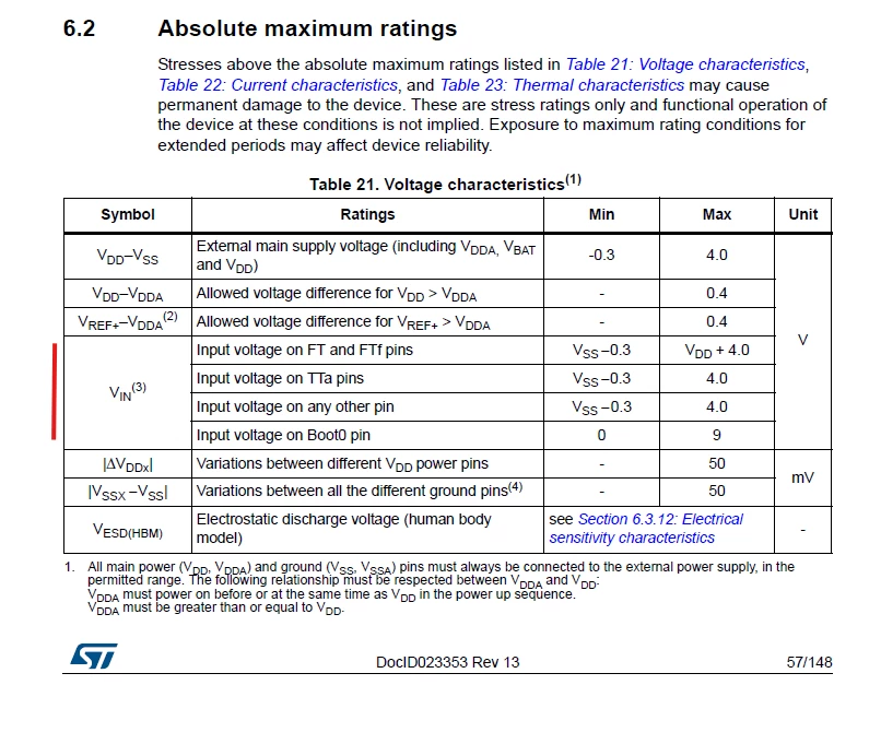

In addition to the other mentioned points, look at the datasheet. Here an example for a F30x MCU :
The (-0.3V) is the average forward voltage of a shottky diode.
