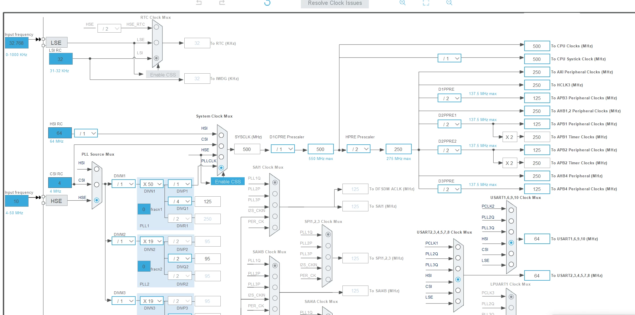

Can I implement a nanosecond delayed signal output with the stm32H723 chip
I would like to implement delay signal output with STM32 MCU.
So I use the original signal input for EXT interrupt.
EXT interrupt's callback activates the timer
If a timer callback is called after a time delay of the desired value, it is implemented by setting the GPIO pin to HIGH.
However, it can be confirmed that the desired amount of delay is achieved, but the timing of the pin becoming HIGH varies each time, and it takes about 1.5 to 1.8us between EXT and TIMER.
I would like to know if the idea can be implemented as STM32 MCU series.
also posting my Clock Configuration pic

The MCU core seems to be running at 500MHz and the timers at 250MHz.
That's 2 nano second and 4 nano second clock period respectively.
Then there is interrupt latency, synchronization between peripheral and core, flash latency, overhead of io-functions. You might be able to get a latency of about 100 CPU cycles give or take. I doubt it can be lower than 50.
So you can get perhaps a 200 nanosecond delay using your approach.
There might be a way to use peripherals only to get an input to an output, but you are still limited by the clock period of 4 nanosecond.

Dec 17, 2025 2:20 AM UTC
I have already completed the code implementation using the EXTI → Timer → GPIO HIGH flow.
With the prescaler configuration shown in the attached clock configuration image, I am able to achieve a nominal delay resolution of approximately 4 ns.
However, I suspect that the latency introduced by the EXTI interrupt and the timer interrupt is not constant on each occurrence. As a result, the GPIO rising edge timing varies within a range of approximately 500 ns.
Therefore, my main question is whether there is any method to minimize this jitter within the STM32 MCU architecture, or if this behavior is an inherent limitation of STM32 when using an interrupt-based approach.
Any clarification on whether this level of jitter can be reduced further, or if a different hardware-based approach is required, would be appreciated

Put code and vector table in RAM, don't use other interrupts, and the interrupt jitter should be a couple cycles max. Of course, writing to GPIO has latency of its own.
This would be better implemented on a simpler chip such as the F4 where you could eliminate jitter.
Probably there are better ways of implementing this than a CPU-based approach.

MasterT
MasterTBest answer
Lead II
Dec 17, 2025 3:34 AM UTC
Configure timer in slave_triger mode, ETRF pin as a trigger. OnePulse PWM. There 'd be latency about 20-30 nsec - so it's minimum delay, resolution 2 nsec. No interrupt, all in hardware
