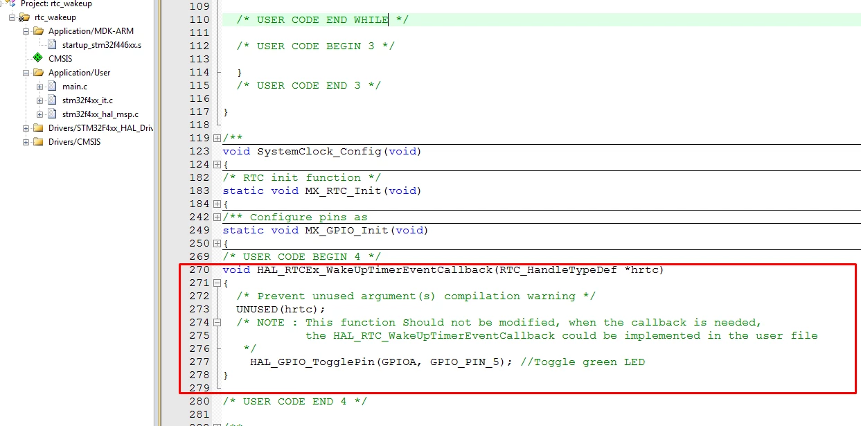

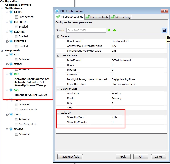

    I have configured the wakeup Timer with CubeMx:
    For 3 Seconds:
    In the main.c File I added and using the Wakeup-Callback function:
