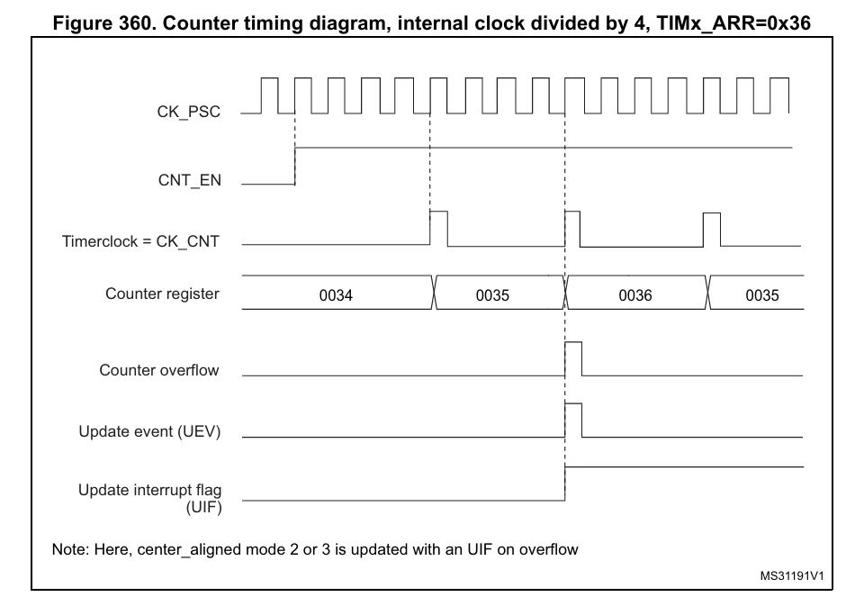

Can I configure a Timer in center-aligned mode to start counting from a value other than 0?
Hi everyone,
I'm using an STM32 timer in center-aligned mode, and I would like the counter to start from a value other than zero. Specifically, I want the timer to count from a custom value (e.g., 2000), up to the auto-reload value (ARR), and then count down again, repeatedly — like a normal center-aligned operation, but starting from a value other than 0.
Is there a way to set the initial value of the counter before the counting starts, so that the up/down counting occurs between a custom starting point and the ARR value?
I’m aware that I can use __HAL_TIM_SET_COUNTER() to set the counter to a custom value, but I’m not sure how it behaves in center-aligned mode or whether it interferes with the timing or alignment.
Any ideas or suggestions would be greatly appreciated!
Thanks in advance.

Yes, set the counter value prior to starting the counter and it will start from there.
For example:

April 26, 2025
What chip are you using?
Step through the code and, when the timer is enabled via the CEN bit, ensure that CNT=999 as you have set it. Consider setting the timer update frequency to 1 Hz so you can examine the registers at human speeds to see what's going on. I didn't test it but the Reference Manual is likely correct. It may not be possible to do this with HAL. If you are particular about the very first pulse, you may need to write your own code, but if you just want TIM1 and TIM8 to be offset, as it appears, should be able to do that with HAL.
