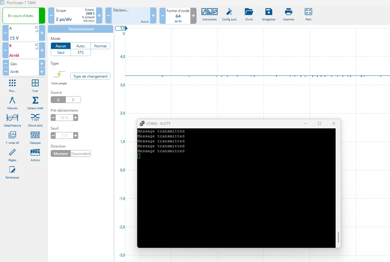

So , i am facing a problem to display the frame i am supposed to send from CAN_Tx pin in loopback mode. I am using picoscope to display.
Here is the function i wrote to configure the Header, and send the data:

In the Main function, i am calling it after the HAL_CAN_Start function. The uart connexion tells me that the frame is sent but i can't see it though.

Thank you for the shared main file:
I noticed two issues:
In the timing configuration:
hcan1.Init.TimeSeg1 = CAN_BS1_1TQ;
hcan1.Init.TimeSeg2 = CAN_BS2_8TQ;
And with the filter configuration:
canfilterconfig.FilterBank = 10;
canfilterconfig.SlaveStartFilterBank = 0;
So try these configurations:
 hcan1.Init.TimeSeg1 = CAN_BS1_7TQ;
 hcan1.Init.TimeSeg2 = CAN_BS2_2TQ;
and
 canfilterconfig.FilterBank = 0;
 canfilterconfig.SlaveStartFilterBank = 14;
6 replies

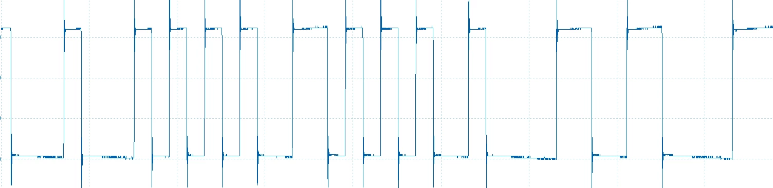

Erwan03Author
March 25, 2024
Nothing changed:
Let me inform you than i got it to work once but several weeks ago and when i added some structures and other functions in order to fit it into a real project then it couldn't work anymore. And the parameters you asked me to change were the same unfortunately.
Erwan03Author
March 25, 2024
Wait Wait! It works actually.
The debug mode does not allow us to see a frame. Only run mode. Thank you for your help!
Have a nice day!
