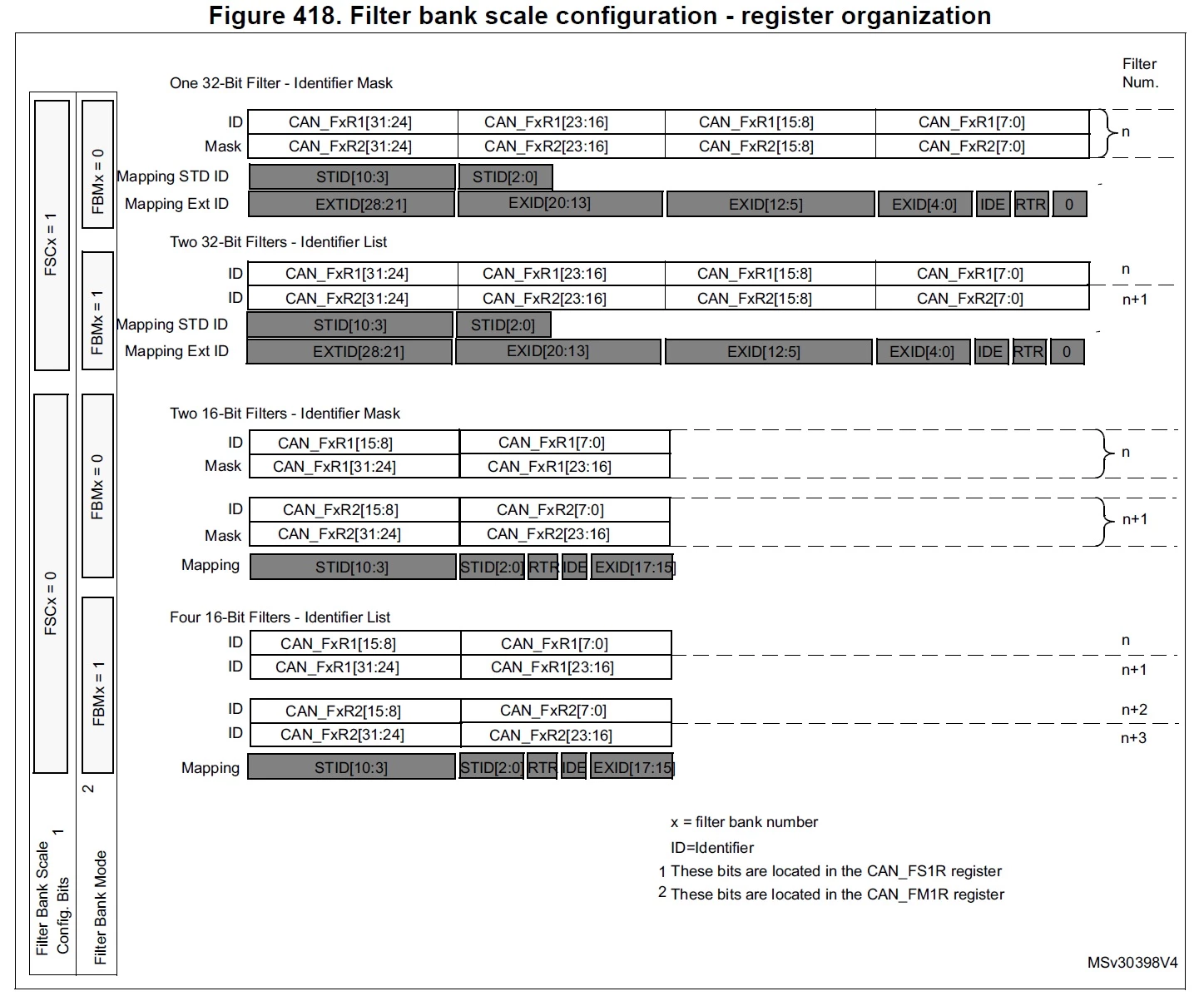

How does one define the filter for a CAN A message, when the ID is only 11 bits?
If using 16-bit filter, what should be put to the EXTID[17:15]?

    Nov 13, 2018 9:51 PM UTC
    Match = (ID << 5)
    Mask = 0x7FF << 5;
    Let me go find the diagram, I've posted it a bunch of times to older iteration of the forum...

    Nov 14, 2018 4:33 AM UTC
    Just that CAN A does not have EXTID. CAN A ID is only 11 bits.
    What do the EXTID-bits match to?
    Or maybe one needs to use masking with CAN A?

    Nov 14, 2018 5:17 AM UTC
    Whatever you have on the wire, it is a one-to-one deal, not magic. If it's random crap you're going to need to mask it...

    Nov 14, 2018 6:01 PM UTC
    As I thought. Thanks for confirmation.
