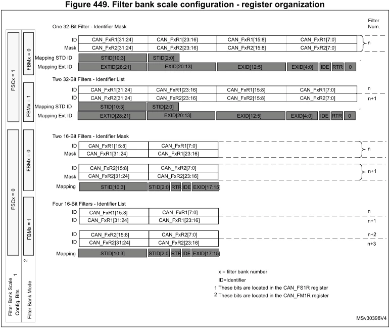

    I solved the to problem to filter only the 0x2222 id messages:
    /* CAN filter init */
    CAN_FilterInitStructure.CAN_FilterNumber=0;
    CAN_FilterInitStructure.CAN_FilterMode=CAN_FilterMode_IdMask;
    CAN_FilterInitStructure.CAN_FilterScale=CAN_FilterScale_32bit;
    CAN_FilterInitStructure.CAN_FilterIdHigh=( (0x2222 << 3) >> 16);
    CAN_FilterInitStructure.CAN_FilterIdLow=( (0x2222 << 3) & 0xFFFF);
    CAN_FilterInitStructure.CAN_FilterMaskIdHigh= ( (0xFFFFFFFF>>3)>>16);
    CAN_FilterInitStructure.CAN_FilterMaskIdLow= ( (0xFFFFFFFF << 3) & 0xFFFF);
    CAN_FilterInitStructure.CAN_FilterFIFOAssignment=0;
    CAN_FilterInitStructure.CAN_FilterActivation=ENABLE;
    CAN_FilterInit(&CAN_FilterInitStructure);

    I'm sending a message by CAN using a Extend Id 0x2222. What the configuration I have to use in the Filter to receive only this Extend Id messages, setting the IDList filter?
    I tried to configurate the Filter Low with 0x2222, but didn't works.
    CAN_FilterInitStructure.CAN_FilterMode=CAN_FilterMode_IdList;
    CAN_FilterInitStructure.CAN_FilterIdHigh=0x0000;
    CAN_FilterInitStructure.CAN_FilterIdLow=0x2222;
    CAN_FilterInitStructure.CAN_FilterMaskIdHigh=0x0000;
    CAN_FilterInitStructure.CAN_FilterMaskIdLow=0x0000;

    Hi Vinicius.
    Thanks for that this helped me get this working. For the below, what is the purpose of the "<<3" bitwise move? I cannot see the need for this in the reference manual.
    Nevertheless is works on my MCU. :)
    Andrew Hazelton
    March 14, 2019
    Oh wait I see.... RM0385 Rev 8, Figure 449, page 1307. You have to move the EXID 3 places bitwise to the left (<<3) as the [2:0] bits of EXID are for IDE, RTR & 0. It all makes sense now.

    Yes, exactly. Basically masking the data on the wire and then comparing the remaining bits for a match.
