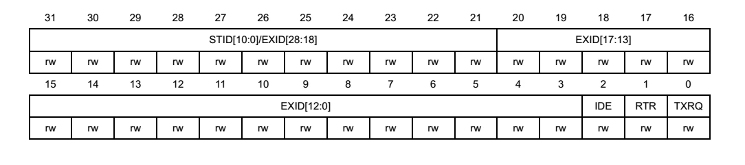

I set on a slave
 CAN_FilterInitStructure.CAN_FilterNumber = 0;
 CAN_FilterInitStructure.CAN_FilterMode = CAN_FilterMode_IdMask;
 CAN_FilterInitStructure.CAN_FilterScale = CAN_FilterScale_32bit;
 CAN_FilterInitStructure.CAN_FilterIdHigh = 0x0000;
 CAN_FilterInitStructure.CAN_FilterIdLow = 0x0064;
 CAN_FilterInitStructure.CAN_FilterMaskIdHigh = 0x0000;
 CAN_FilterInitStructure.CAN_FilterMaskIdLow = 0x00FF;
 CAN_FilterInitStructure.CAN_FilterFIFOAssignment = 0;
 CAN_FilterInitStructure.CAN_FilterActivation = ENABLE;
 CAN_FilterInit(&CAN_FilterInitStructure);
master sends
TxMessage.ExtId = (opcode << 8) | 0х64;
but the slave dosen't get the message. without mask and filter the slave gets the message.
how should I set the mask and filter?

    here you can see some bits are high in the mask ? only these bits are tested in the filter
    //##-2- Configure the CAN1 Filter ###########################################
    sFilterConfig.FilterNumber = 0;
    sFilterConfig.FilterMode = CAN_FILTERMODE_IDMASK;
    sFilterConfig.FilterScale = CAN_FILTERSCALE_32BIT;
    sFilterConfig.FilterIdHigh = 0x400 << 5; //11-bit ID in top bits
    sFilterConfig.FilterIdLow = 0x0000;
    sFilterConfig.FilterMaskIdHigh = 0x600 << 5; // resolves as 0x0400 - 0x05FF
    sFilterConfig.FilterMaskIdLow = 0x0000;
    sFilterConfig.FilterFIFOAssignment = 0;
    sFilterConfig.FilterActivation = ENABLE;
    sFilterConfig.BankNumber = 0;
    The Mask is 0x600 // only these two bits are tested
    The Filter is 0x400 // in those two bits, A9 must be high and A10 must be low,
    everything else is "dont care", we only care about the Masked bits.
    so anything within 0x400- 0x5FF is accepted

    But in my case - if I want to accept the messages only for ID = 0xXX64 (XX - don't care) - my settings above seems to be valid. However I don't get any messages with the filter applied.
    T J
    Senior III
    October 21, 2018
    can you see my mask bits are shifted up 5 bits ?
    Erenburg.Evgeny
    October 21, 2018
    Ah... I see. The mask should be shifted. Thank you.
    Erenburg.Evgeny
    October 21, 2018
    I just can't understand - why shift 5? It should be 3.
     Ah...I see. STDID is in High part of the register.

    Depends on what you're matching, the top half of the diagram is the High and the bottom is the Low portion.
    For the STDID you want to use the high filter with the pattern shifted left 5 bits.
    Filters have been described on the forum multiple times over close to a decade. ​

    I want to get ID = 0x64 , the rest don't care
    CAN_FilterInitStructure.CAN_FilterIdHigh = 0x0064 << 5;
    CAN_FilterInitStructure.CAN_FilterIdLow = 0x0000;
    CAN_FilterInitStructure.CAN_FilterMaskIdHigh = 0x00FF << 5;
    CAN_FilterInitStructure.CAN_FilterMaskIdLow = 0x0000;
    But when a master sends ID = 0x1164 I don't get it with the filter applied.
    T J
    Senior III
    November 4, 2018
    is that an extended ID ? or std ID ?
    is that address outside the address range ? 0x1164 << 5 overruns the 16bit value...
    if you are using extended IDs, then <<3 is correct...
    Erenburg.Evgeny
    November 5, 2018
    Thank you. That was my mistake. I have an extended ID.
    So if I have an extended ID it should be this way?
     CAN_FilterInitStructure.CAN_FilterIdLow = 0x0064 << 3; CAN_FilterInitStructure.CAN_FilterMaskIdHigh = 0x0000;
     CAN_FilterInitStructure.CAN_FilterMaskIdLow = 0x00FF << 3;
