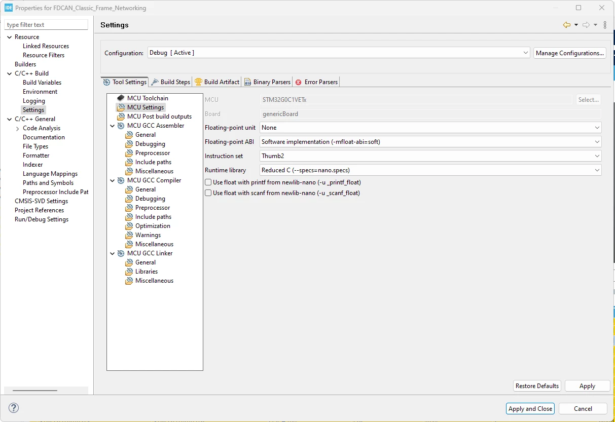

Visitor II
August 10, 2023
I forgot to mention this..... The project properties to change the MCU type is not available.
Visitor II
August 10, 2023
Hello Amel,
Please tell me what are the exact steps to porting the FDCAN_Classic_Frame_Networking example from the STM32G0C1VETX CPU you reference above to my STM32H735IGK6 CPU on my STM32H735G-DK board. I have tried importing the project and importing the example, creating a new project with the h735 and importing source from the G0C1, but CubeIDE still references the old  STM32G0C1VETX builds files and fails.
mƎALLEm
November 17, 2023
Hello @tmlee_mts ,
Refer to Projects\STM32H743I-EVAL\Examples\FDCAN\FDCAN_Classic_Frame_Networking (from STM32CubeH7) instead of STM32G0C1 (not the same family). But you have to check the clocks where you have some differences.
