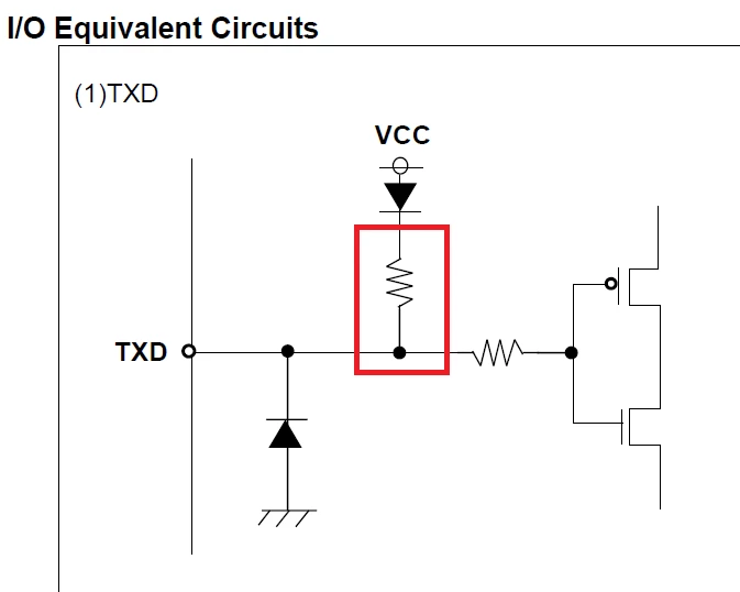

I am trying to connect 2 NUCLEO-G0B1RET6 boards,using CAN FD. I previously did it using CAN, But now i am trying to connect these boards using CAN FD. So far no success,I want to know if it is possible to do it using CANFD.Kindly help me in this regard.

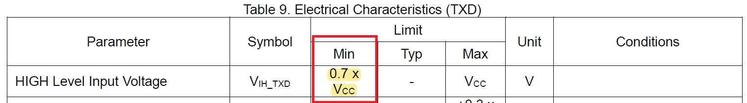

Another important point to consider:
From your tranceiver datasheet: it's a 5V one (VCC Min: 4.75V, Max: 5.25V)
If I consider you supply it with around 5V, you have an issue with TxD pin minimum 'High level input voltage':
VIHmin = 0.7 x VCC = 3.5V > IO voltage level provided by the STM32G0 pin (@3.3V).
Even with VCCmin: VIHmin = 0.7 x 4.75 = 3,325V really at the limit!
November 8, 2023
What would be your suggestion to overcome this problem?
mƎALLEm
November 8, 2023
Simply use 3.3V transceiver or use voltage level shifter for the final project.
But for testing I think there is an internal pull-up resistor connected to the transceiver TxD pin:
Try to configure CAN_Tx pin in Open Drain. But I cannot guarantee this workaround.

November 9, 2023
VIHmin  = 5.05V x 0.7 = 3,535V > 3.316V (VDD) -> out of the transceiver spec. As I said, you have to use a 3.3V transceiver. Or test TxD pin in OD config
