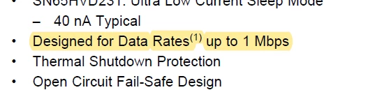

Also the transceiver SN65HVD230 is designed for 1 Mbps data rates max:
0693W00000Y9FHLQA3.pngSo if you are exceeding 1Mbps for CAN FD transmission you are out of specification of the transceiver.
PS: you don't need a common GND between the nodes since CAN signals are driven in differential mode.
