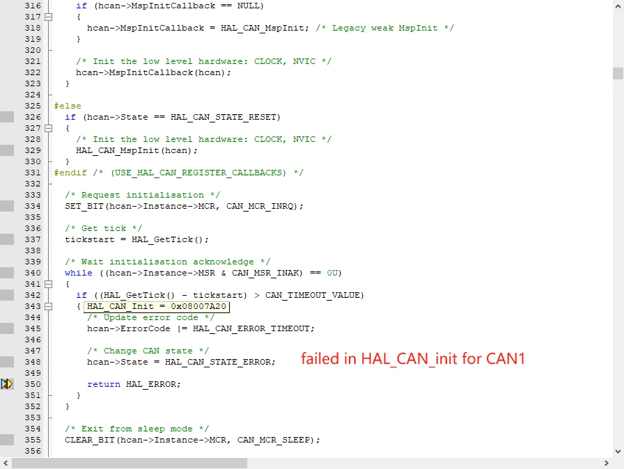

Can failed to reinit after deinit.
1. Two cans was used for my projects which was generated by stm32cubemx
2. after run for a short while , I turn off both cans by HAL_CAN_DeInit
3. then I reinit both cans by MX_canx_init and found it failed in HAL_CAN_Init
4. I have tried to pull both can rx and tx pins but does not work
5. Before reinit I have checked both rx and tx pins is high

Hi SofLit:
   Thanks for your reply.
   I have found the reason is that I deinit the same can twice which cause the reinit failure.
  After modify code the can reinit successfuly.

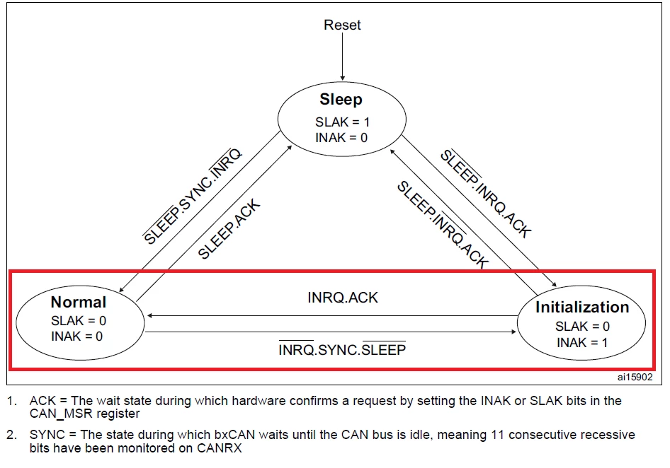

Hi SofLit:
    I have measured Can_rx pin is high during reinit which means recessive bits.
    reinit still failed.
    is there any other reason for reinit fail?
mƎALLEm
July 5, 2024
As stated in the thread I gave, did you implement this requirement?:
