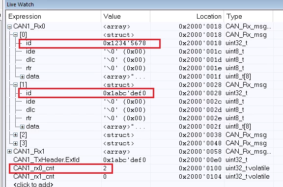

It works well on an STM32F769 NUCLEO board:
This is my IAR screenshot and I'm receiving the two IDs:
Attached the project with which I got this result.
So please double check your CAN config as well as your filter config. Are you using CAN2?

mƎALLEmBest answer
December 15, 2023

mƎALLEm
December 15, 2023
Using CAN2 is another story ..
1- You need to enable CAN1 RCC clock (__HAL_RCC_CAN1_CLK_ENABLE()) even if it was not used.
2- Regarding the filtering you need to take care about these two parameters:
.SlaveStartFilterBank and .FilterBank.
Please read the attached text file.
AnnoAuthor
January 3, 2024
With your explanation and the knowledge that the behavior is different with CAN2, I tried the example you gave above and it works. Many thanks for that!
