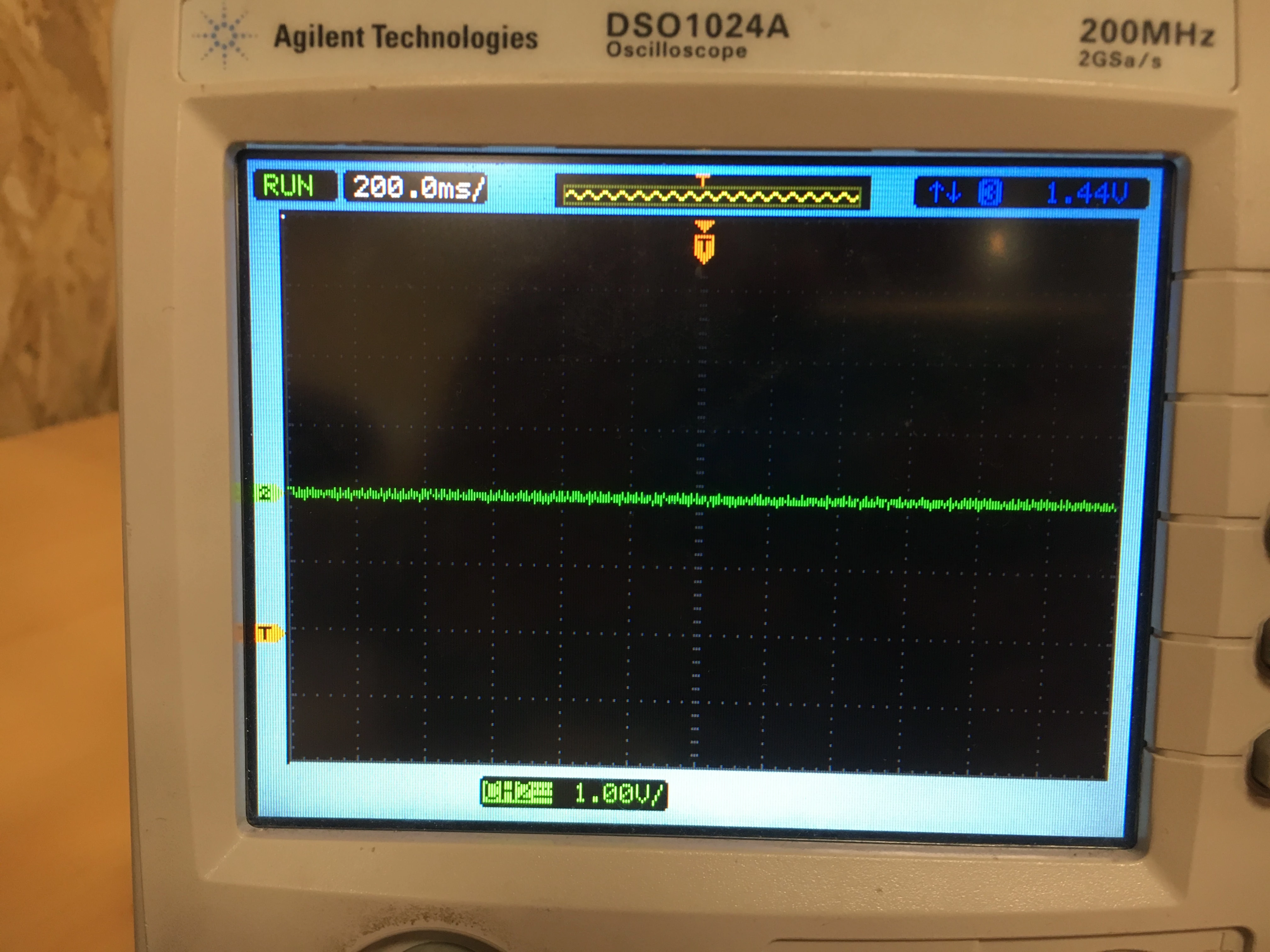

However when i check the CAN_Tx on the oscilloscope, nothing is send
PS: i've been looking different topics on the internet but nothing solved my problem.

Jack Peacock_2
July 31, 2020
CAn requires a minimum of two nodes to work. You also need a twisted-pair cable with termination resistors at each end. Connecting the TX and RX pins is NOT a CAN hardware loopback.
If you check the CAN status registers you will see TX errors and a bus disconnect in effect, which is why you don't see anything on the scope.

0693W000003BqbNQAS.pngHere is the manip i want to verify
Nikita91
Lead II
July 31, 2020
Your wiring to use CAN without drivers is wrong.
Look at: https://www.mikrocontroller.net/attachment/28831/siemens_AP2921.pdf
The CAN is not an UART!

Nikita91
Lead II
August 3, 2020
The CAN bus is a broadcast type of bus. This means that all nodes can “hear�? all transmissions.
If one node receive a correct message it will ACK this message.
If the message is not acked, probably the sender will retry.
The CAN bus timing is very tight.
For my information, what is the "broadcast module" you use ?

Hi everyone,
Some BAD news -_-,
I directly tested the wireless experiment :
PS: I connect a GND between the 2 MCU.
But nothing happens... no CAN frames sent on Can1_Tx on the scope.

I can see on the scope the CAN frame sent by the two boards on the CAN1_Tx pins. However they aren't received and aren't treated by the HAL_CAN_RxFIFO0MsgPendingCallback (My led configured on pin_14 doesn't blink)
Moreover I tried with my wireless module, but nothing happens (no frame observed on CAN1_Tx pin on the scope )
I verified my configuration and initialisation without conclusive results.
Thx for help,
Uvess

Hi everyone,
i'm still working on this case,
It seems that my "HAL_CAN_RxFifo0MsgPendingCallback(CAN_HandleTypeDef *hcan)" is never called.
I tried to modify the code without sucess...
When I'm looking other topics and code used i didn't see the difference with mine.
EDIT1:
Using the same code on each card all works perfectly,
Next step is to integrate my wireless module in the circuit to exchange data.
If anyone have an idea, i'll be grateful
Thanks in advance
Uvess
