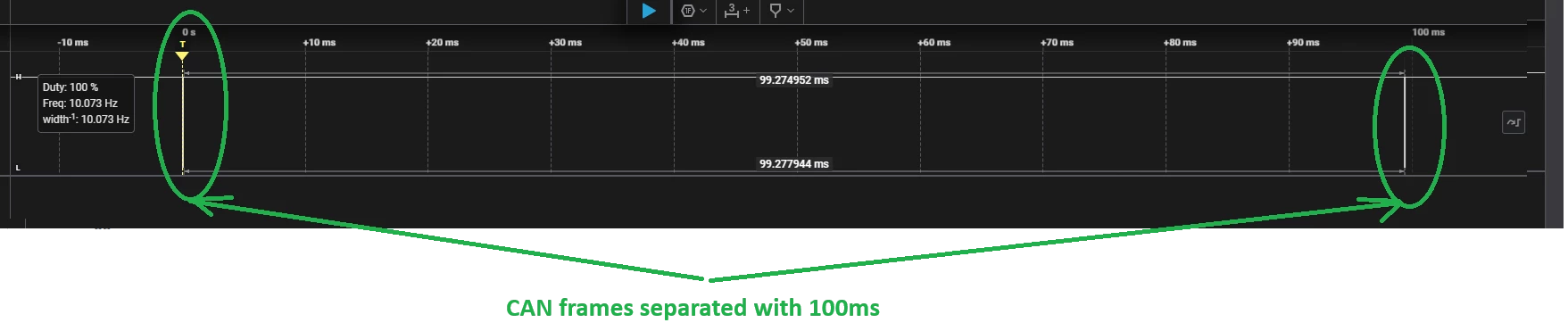

By testing your configuration and by adding a pin that toggles inside the timer interrupt, it seems the timer callback is firing each 100ms (PD0 is toggling):
void HAL_TIM_PeriodElapsedCallback (TIM_HandleTypeDef *htim){
	HAL_GPIO_TogglePin(GPIOD, GPIO_PIN_0);
//	if (htim->Instance == TIM2){
//		CAN_SendMessage();
So I don't know how you did conclude that the interrupt is firing each 1ms?
I'm attaching the project for your reference.

This is a timer related question. So for now forget about CAN communication and try to generate a periodic timer interrupt with 100ms of interval.
You need also to attach your ioc file as others can help you efficiently.

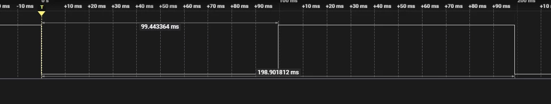

And this is the CAN frames transmission each 100ms:
Attached the project where PB8 and PB9 are used for CAN_Tx/Rx as PA11 and PA12 are not exposed on the board connector.

Which software are you using to visualize the CAN frames?
mƎALLEm
Mar 10, 2025 10:52 AM UTC
It's a logic analyzer from https://www.saleae.com/
