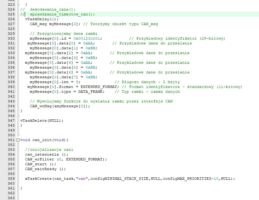

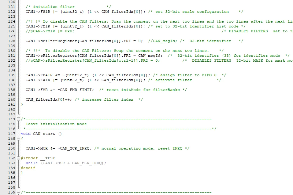

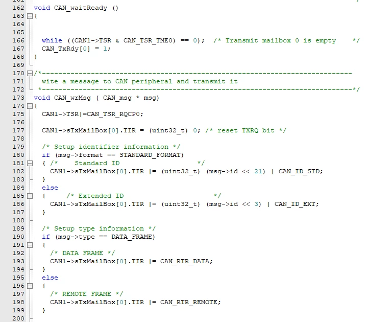

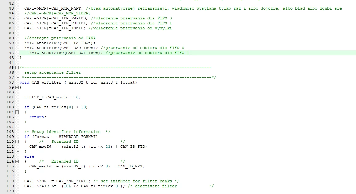

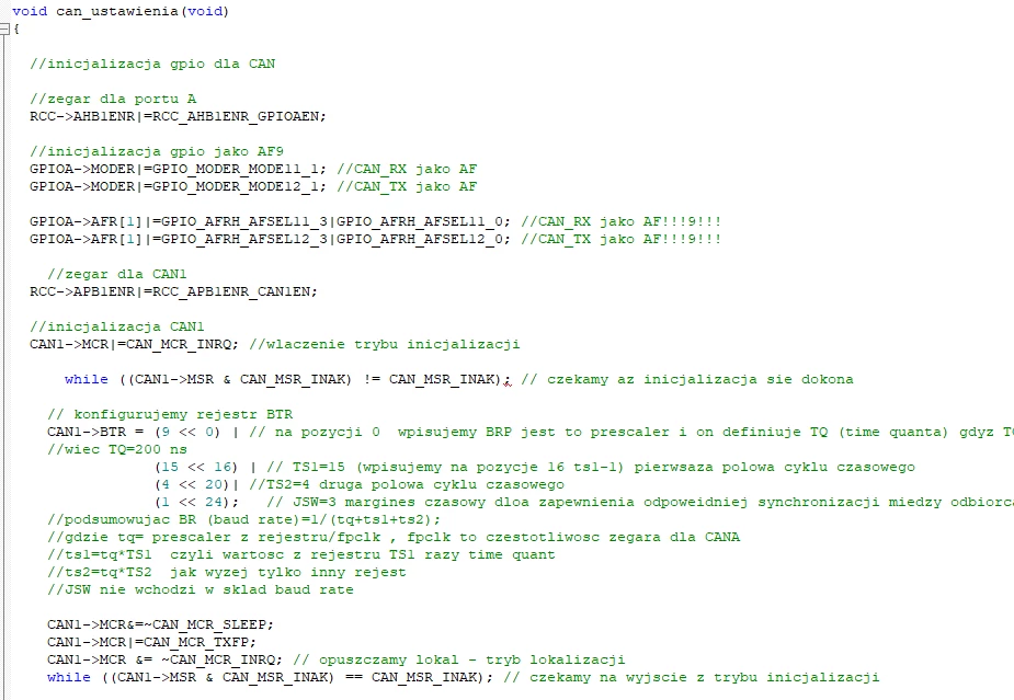

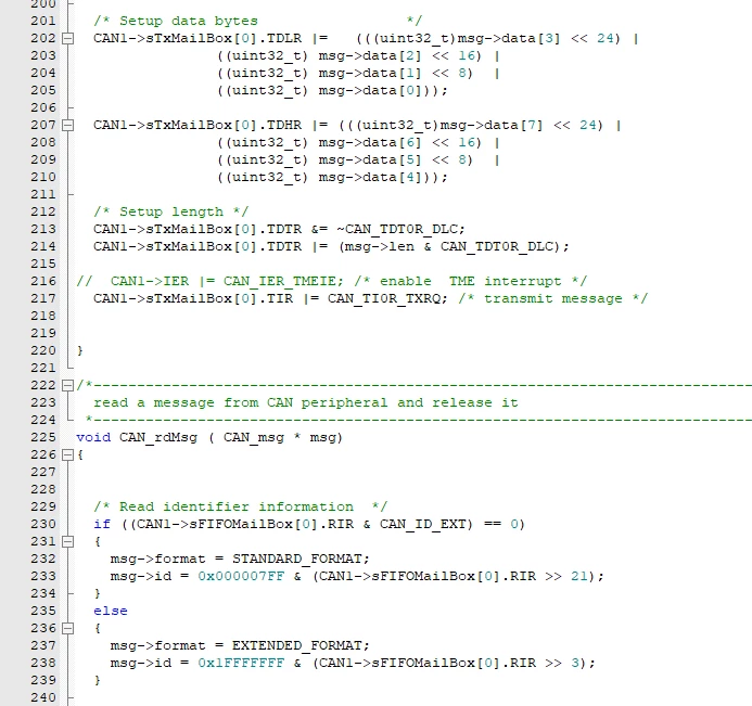

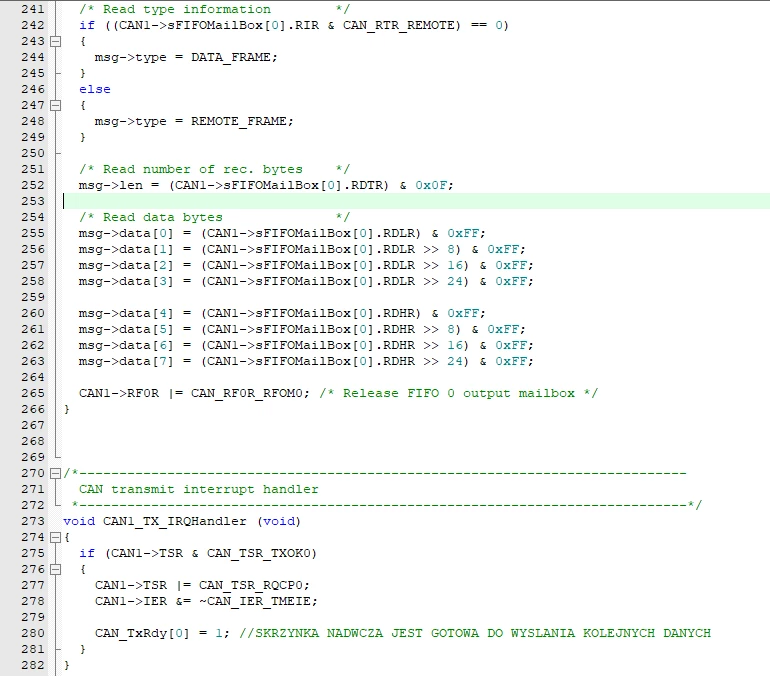

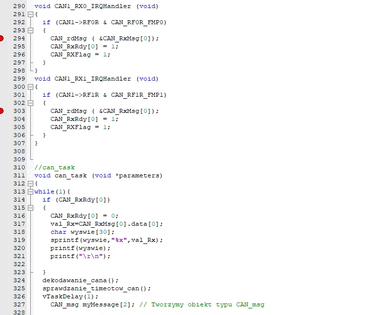

Hello, I initialized CAN on STM32F429ZIT6 on registers. I would like to tranmitt and receive messages. But on transmission lines is silence. In my opinion I forgot about any register, but I don't know which. So could you help me what i sholud change in my code?inic.PNGinic2.PNGinic3.PNGinic4.PNGinic5.PNGinic6.PNGinic7.PNGinic8.PNG

Before going ahead with the baremetal, please use the HAL to validate the hardware and the software then try to simplify your code by following the register call sequence in the HAL.
