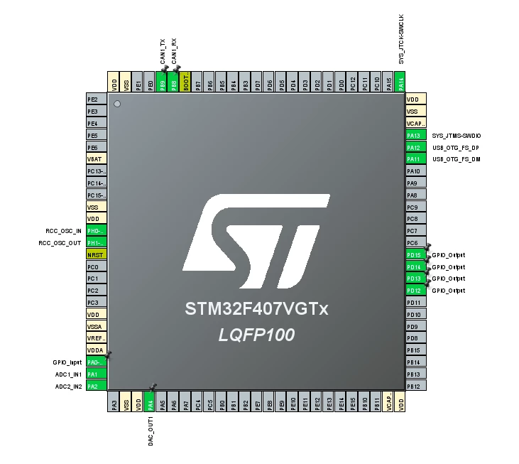

Hello everyone,
I’m currently experiencing difficulties with setting up CAN communication on my STM32F4 microcontroller. Despite having configured the CAN interface and connecting it to a CAN transceiver, I observe no activity on my designated can_tx and can_rx pins. I have a second node connected for communication testing.

ADC_HandleTypeDef hadc1;
ADC_HandleTypeDef hadc2;
CAN_HandleTypeDef hcan1;
CAN_HandleTypeDef hcan2;
DAC_HandleTypeDef hdac;
/* USER CODE BEGIN PV */
CAN_TxHeaderTypeDef myTxHeader;
uint8_t TxData[8];
uint32_t TxMailbox;
uint32_t adcValue1, adcValue2;
/* USER CODE END PV */
static void MX_CAN1_Init(void);
static void MX_CAN2_Init(void);
static void MX_DAC_Init(void);
static void MX_ADC1_Init(void);
static void MX_ADC2_Init(void);
/* USER CODE BEGIN PFP */
void DAC_SetComparisonVoltage(void);
void ADC_Scan_RegularChannels(void);
void Send_CAN_Message(void);
void Send_USB_Data(void);
void ToggleErrorLED(uint8_t number_of_blinks);
/* USER CODE END PFP */

 hcan1.Instance = CAN1;
 hcan1.Init.Prescaler = 6;
 hcan1.Init.Mode = CAN_MODE_NORMAL;
 hcan1.Init.SyncJumpWidth = CAN_SJW_1TQ;
 hcan1.Init.TimeSeg1 = CAN_BS1_11TQ;
 hcan1.Init.TimeSeg2 = CAN_BS2_2TQ;
 hcan1.Init.TimeTriggeredMode = DISABLE;
 hcan1.Init.AutoBusOff = DISABLE;
 hcan1.Init.AutoWakeUp = DISABLE;
 hcan1.Init.AutoRetransmission = ENABLE;
 hcan1.Init.ReceiveFifoLocked = DISABLE;
 hcan1.Init.TransmitFifoPriority = DISABLE;
 if (HAL_CAN_Init(&hcan1) != HAL_OK)
 ToggleErrorLED(8); // Toggle LED achtmal für Fehler in CAN1_Init
 myTxHeader.StdId = 0x321;
 myTxHeader.ExtId = 0x00;
 myTxHeader.RTR = CAN_RTR_DATA;
 myTxHeader.IDE = CAN_ID_STD;
 myTxHeader.DLC = 8;
 myTxHeader.TransmitGlobalTime = DISABLE;
value = HAL_CAN_AddTxMessage(&hcan1, &myTxHeader, TxData, &TxMailbox);
if (value != HAL_OK)
ToggleErrorLED(2); // Toggle LED zwölfmal für Fehler bei Send_CAN_Message

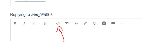

First, there is a source code formatting tool which makes code snippets much more readable:
And second, there is a lot of irrelevant code which clutters the post.
Just sticking to CAN functionality would make it more readable.

Sorry, I'm a bit of a forum newbie. Thanks for pointing out the clutter; I'll focus on the CAN functionality now.
I use STM32CubeMX to initialize the pins and most registers.
My board is the STM32F407G-DISC1, and though it might not be relevant, the transceiver I’m using is the LTC2875. To my knowledge, the pin configuration isn’t directly visible in main.c
I've already looked for examples but haven't found any specific to my board configuration yet. If you have any suggestions or know where I might find a suitable example, I’d appreciate it.
I'll take your suggestion to try a proper CAN example, perhaps starting with a loopback test to troubleshoot the initialization issue further.
Thanks again for your help!
I am no Cube user, I'm not sure where the GPIO initialisations are "hidden".
The CAN transceiver is basically only logic, so the type does not really matter.
But the board matters- the F4 Discovery is "old-school", being released quite a while before ST switched from the SPL ("Standard Peripheral Library") to Cube. Which means there are very few - if any - Cube examples available.
The "legacy" firmware package for F407 contains two CAN examples. In the version I have (V1.8.0), these are  :
..\STM32F4xx_DSP_StdPeriph_Lib_V1.8.0\Project\STM32F4xx_StdPeriph_Examples\CAN\CAN_Loopback and
..\STM32F4xx_DSP_StdPeriph_Lib_V1.8.0\Project\STM32F4xx_StdPeriph_Examples\CAN\CAN_Networking.
Check with F4 Discovery schematics which pins are free.
It seems this are only CAN_2 and PB12 / PB13 are available, the other pins are connected to onboard peripheral.
