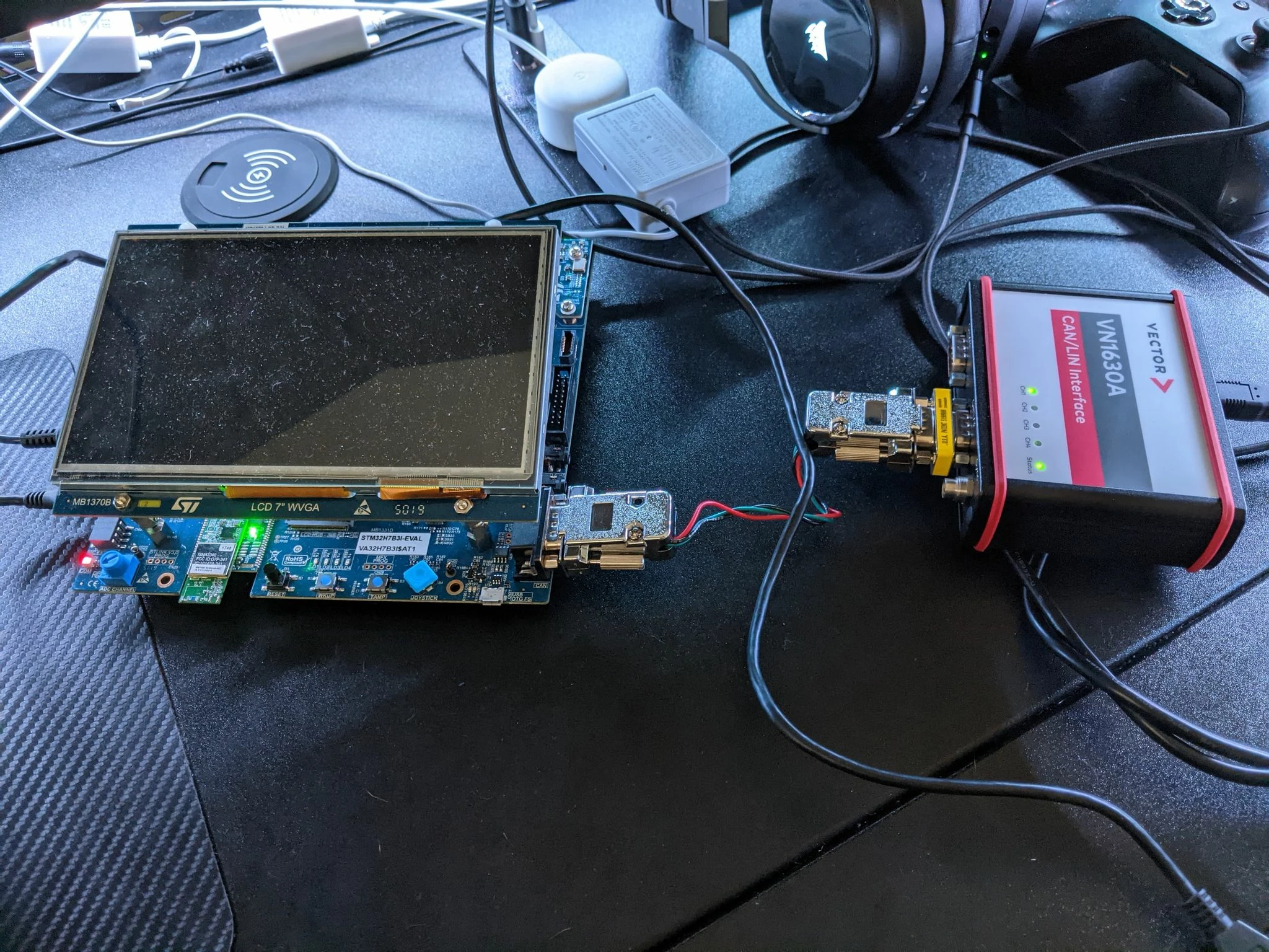

I am attempting to communicate between my STM32H7B3I-EVAL and a Vector CANalyzer (VN1630A).
I previously reached out to figure out why my CAN messages from the CANalyzer are not being received by the STM32 MCU. There was a belief that it was the filters causing the issue, so I did not initialize the filters and tried to see if any message was being received. There are still no messages being received, but I can send them from the STM32 to the CANalyzer without issue.
I would like to find out why my code is not working, but I have some specific questions to try and assist my thought process:
  • If the FDCAN_FilterTypeDef is a defined variable but not initialized, it will not filter, correct?
  • Is the function correct for receiving data from the RXBUFFER?
if(HAL_FDCAN_GetRxMessage(&hfdcan1, FDCAN_RX_BUFFER0, &RxHeader, RxData) != HAL_OK){
Error_Handler();
Setup Picture:0693W00000SvpupQAB.jpg

You are using FDCAN ins classic mode:
 hfdcan1.Init.FrameFormat = FDCAN_FRAME_CLASSIC;
While you are transmitting frames in CANFD mode:
TxHeader.BitRateSwitch = FDCAN_BRS_ON;
TxHeader.FDFormat = FDCAN_FD_CAN;
That couldn't work. These parameters should be set as the following:
 TxHeader.BitRateSwitch = FDCAN_BRS_OFF;
TxHeader.FDFormat = FDCAN_CLASSIC_CAN;
Hope that helps you as well as others ..
