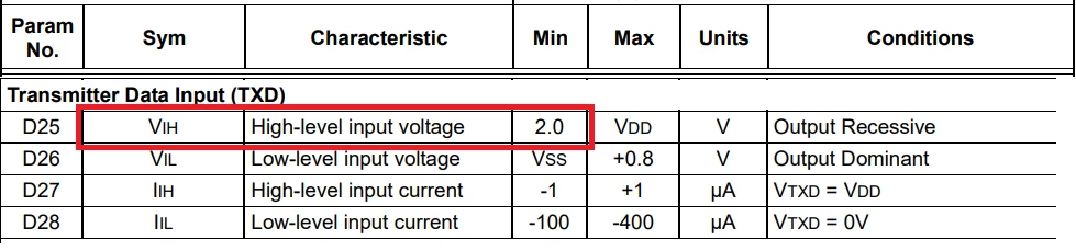

When I set the CAN Mode to LOOP BACK the transmission works fine.
Interrupts: 0x2, msr flags: 0xC08 , tsr flags: 0x1C000003, rf0r flags: 0x0, rf1r flags: 0x0, esr flags: 0x0
Interrupts: 0x2,msr flags: 0xC08,tsr flags: 0x1C000003,rf0r flags: 0x0,rf1r flags: 0x0,esr flags: 0x0
When I run the same code in Normal Mode The same transmit message fails.
hcan2.Init.Mode = CAN_MODE_NORMAL;
Interrupts: 0x2, msr flags: 0xC08 , tsr flags: 0x19000008, rf0r flags: 0x0, rf1r flags: 0x0, esr flags: 0xF80057
Interrupts: 0x2,msr flags: 0xC08,tsr flags: 0x19000008,rf0r flags: 0x0,rf1r flags: 0x0,esr flags: 0xF80057

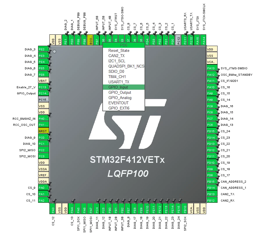

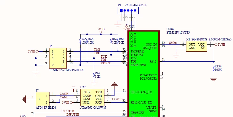

I have to assume that my transceiver must be the problem.
Can2 has another port pin but I think I selected the GPIO ports correctly.

Best answer by mƎALLEm
Hello your the selection of ATA6561 doesn't present an issue.
But since you're not seeing any activity on CAN_Tx pin of STM32, are you sure about the GPIO config? are you sure you selected the correct alternate function that connects CAN_TX to the transceiver?
You need to start at this point ..You need at least to have an activity on CAN_Tx.

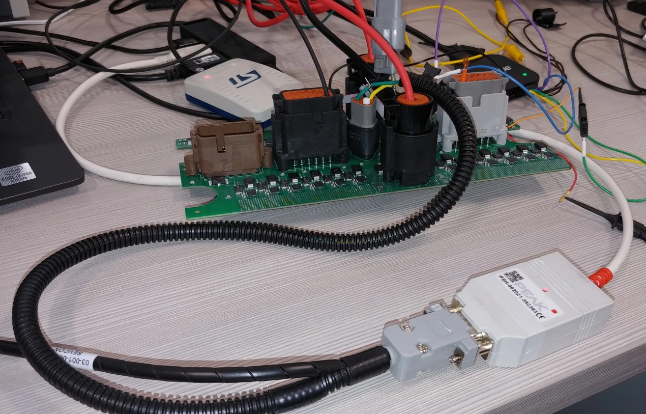

You haven't mentioned what you're trying to send a CAN message to? If you haven't connect your CAN wires to any other CAN bus, then you'll get transmit error.

Three things to check:
  • Is there a second node connected on the other side of the bus? As the sender needs an acknowledgement from at least one node on the bus.
  • If yes, are you using HSE or HSI as system clock source?
  • Did you set the same bitrate at both sides (the two nodes)?
JDOGAuthor
March 14, 2024

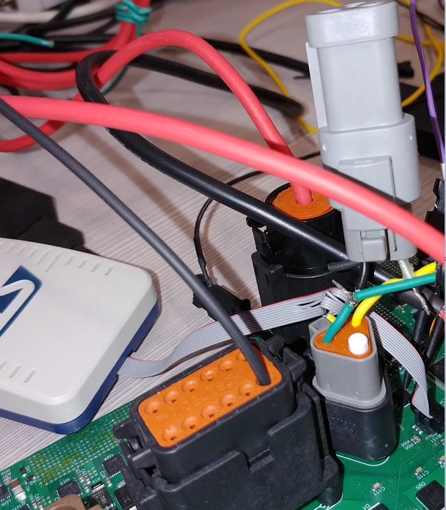

I have a Pcan Dongle hooked up and it is configured to 250Kbits per second and I have verified that it is working with hardware that is transmitting messages.
The bit rate is set at both places at 250 Kbits per second
Yes I am using the HSE as clock source.
The 1 ms clock tick is being generated from a PLL clock so I know the clocks are working off of the 8 Mhz clock

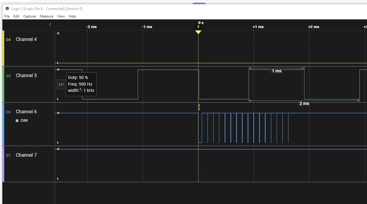

When I send the transmit message I  get the CAN error on channel 6 Blue Trace.
mƎALLEm
March 15, 2024

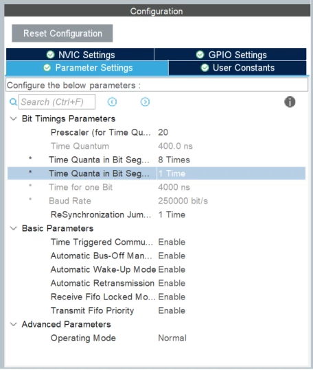

You said you configured your PCAN at 250kb/s but from your ioc file the bitrate is set at 500kb/s!
Could you please double check? (changing the Prescaler (for time Quantom) to 8 instead of 4)
Karl Yamashita

Check also your connections and wiring by doing continuity tests.
What about the termination resistors? Is there a termination resistor inside the PCAN? I don't seen one on the schematics above! You need only two termination resistors of 120ohm on each side of the bus .
Could you please also provide a diagram of your connections including the perceivers and the termination resistors to have a clear view of your HW?

Based off your ABP1 clock, you'll need these settings for 250kbs

The 120 ohm terminator at the CANH and CANL side of the Transceiver is attached with soldering the wires to the (greeen and yellow wires).
There is a terminator in the PCan dongle as well.
mƎALLEm
March 15, 2024
Not sure I can see the resistor but ok.
Now please check your bitrate and see my previous comment:
Could you please double check? (changing the Prescaler (for time Quantom) to 8 instead of 4)"

I ordered an eval board for the ATA6560 transceiver and I will connect it to  my NUCLEO-F412ZG board and test the same CAN code that I have in our current PDM target board. The CAN is the last thing I need going to finish the Power Distribution Module (PDM) firmware for the first prototype.

The STM32F412 uses CAN 2.0B protocol. Not that it won't work, but you don't need a CAN FD transceiver. Since you're using a Microchip product, use the MCP2551 transceiver.
If a reply has proven helpful, click on Accept as Solution so that it'll show at top of the post.CAN Jammer an open source CAN bus hacking toolCANableV3 Open Source
mƎALLEm
March 15, 2024
From voltage levels adaptation standpoint MCP2551 is good as VIH min = 2V:
But he can use FDCAN transceivers for CAN2.0 frames but he needs to think about the cost!

Please show the analog signal.
