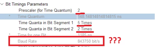

Hello Everyone,
I have a two arduino boards communicating with each other on a CAN Bus. Arduino is connected to CAN Bus via MCP2515 .
Both arduino are communicating correctly with each other. Here is an example of my transmitter on arduino:
#include <SPI.h>
#include <mcp2515.h>
/*******************MESSAGES DEFINITIONS*****************/
#include <SPI.h>
struct can_frame canMsg1;
struct can_frame canMsg2;
MCP2515 mcp2515(10);
void setup() {
 canMsg1.can_id = 0x0F6;
 canMsg1.can_dlc = 8;
 canMsg1.data[0] = 0x8E;
 canMsg1.data[1] = 0x87;
 canMsg1.data[2] = 0x32;
 canMsg1.data[3] = 0xFA;
 canMsg1.data[4] = 0x26;
 canMsg1.data[5] = 0x8E;
 canMsg1.data[6] = 0xBE;
 canMsg1.data[7] = 0x86;
 canMsg2.can_id = 0x036;
 canMsg2.can_dlc = 8;
 canMsg2.data[0] = 0x0E;
 canMsg2.data[1] = 0x00;
 canMsg2.data[2] = 0x00;
 canMsg2.data[3] = 0x08;
 canMsg2.data[4] = 0x01;
 canMsg2.data[5] = 0x00;
 canMsg2.data[6] = 0x00;
 canMsg2.data[7] = 0xA0;
 while (!Serial);
 Serial.begin(115200);
 mcp2515.reset();
 mcp2515.setBitrate(CAN_250KBPS, MCP_8MHZ);
 mcp2515.setNormalMode();
 Serial.println("Example: Write to CAN");
void loop() {
 mcp2515.sendMessage(&canMsg1);
 mcp2515.sendMessage(&canMsg2);
 Serial.println("Messages sent");
 delay(100);
Now I'm trying to receive data on an STM32F753Z8 with a ICTCAN33C71XXXXXXX00 transceiver module but nothing is being received in the STM32F753Z8 from the arduino side. Since the arduino's are communicating to each other.
I ahve also tried to receive the data on Arduino side fro the STM32. But I couldn't get success.
My code for STM32 is attached in a file. Any thoughts on what I'm doing wrong or what I'm missing?
I have set the NVIC interrupt on CAN2 RX1 intr.
Baudrate :250kbps
ABP1 peripheral Clock: 13.5 mHZ

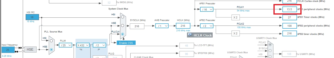

I review your code and seems the CAN bitrate is not set at 250kb/s but rather to non standard bitrate 843750bit/s!!
From your code:
RCC config:
  RCC_OscInitStruct.OscillatorType = RCC_OSCILLATORTYPE_HSE;
RCC_OscInitStruct.HSEState = RCC_HSE_ON;
RCC_OscInitStruct.PLL.PLLSource = RCC_PLLSOURCE_HSE;
RCC_OscInitStruct.PLL.PLLM = 25;
RCC_OscInitStruct.PLL.PLLN = 432;
RCC_OscInitStruct.PLL.PLLP = RCC_PLLP_DIV2;
RCC_OscInitStruct.PLL.PLLQ = 2;
Error_Handler();
CAN bit time settings:
  hcan1.Init.Prescaler = 2;
hcan1.Init.TimeSeg1 = CAN_BS1_5TQ;
hcan1.Init.TimeSeg2 = CAN_BS2_2TQ;
I did the simulation in the CubeMx where the APB1 = 13.5 with CAN prescaler = 2, BS1 = 5 and BS2 = 2
Its gives the following:
PS: there is no part number: STM32F753Z8
Hope that helps you as well as others ..
