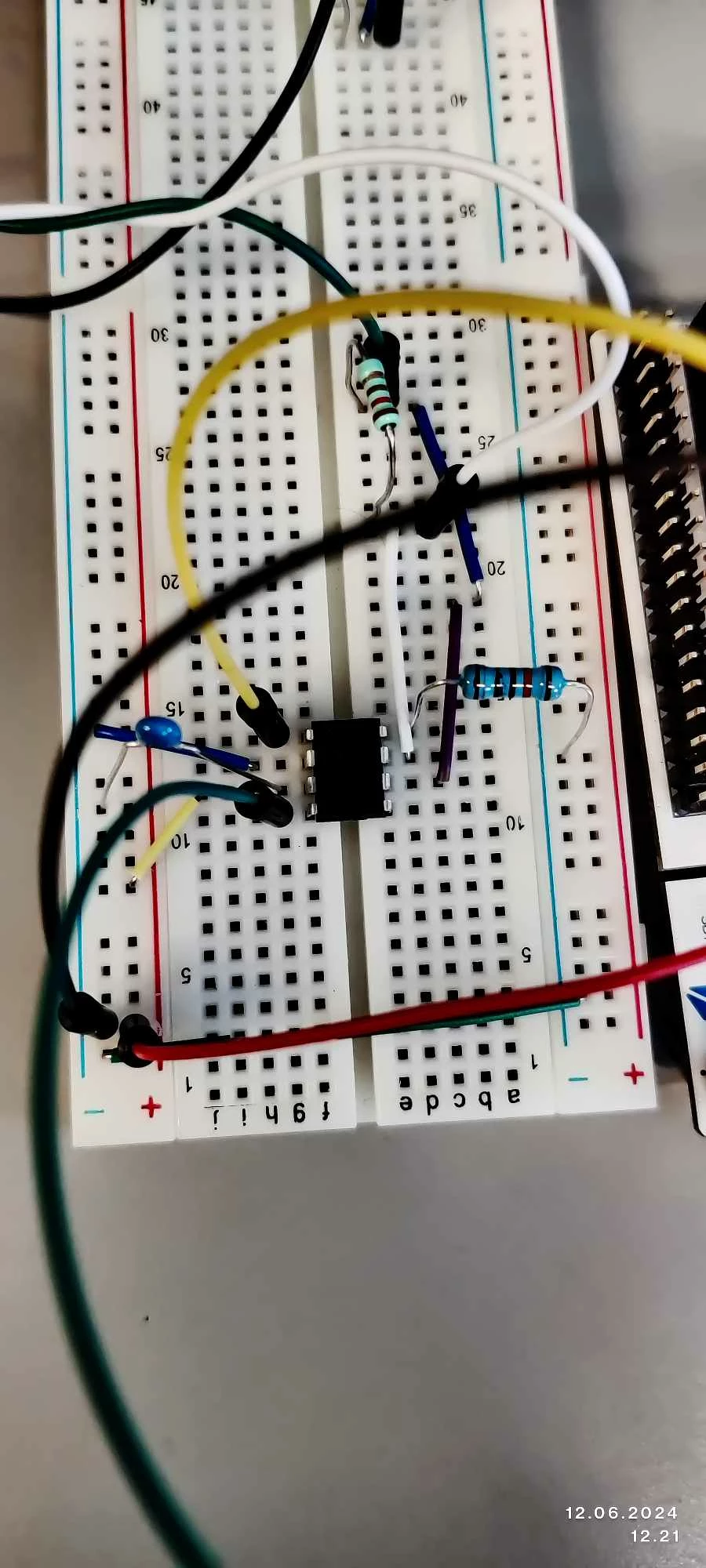

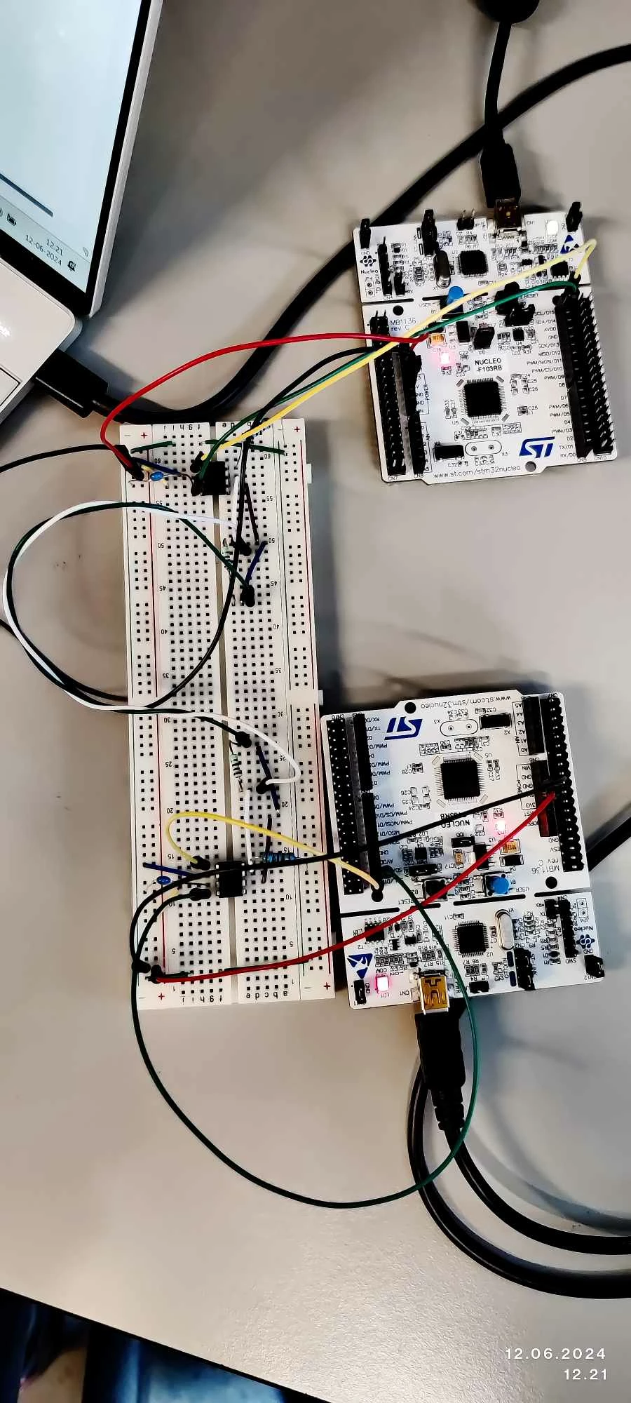

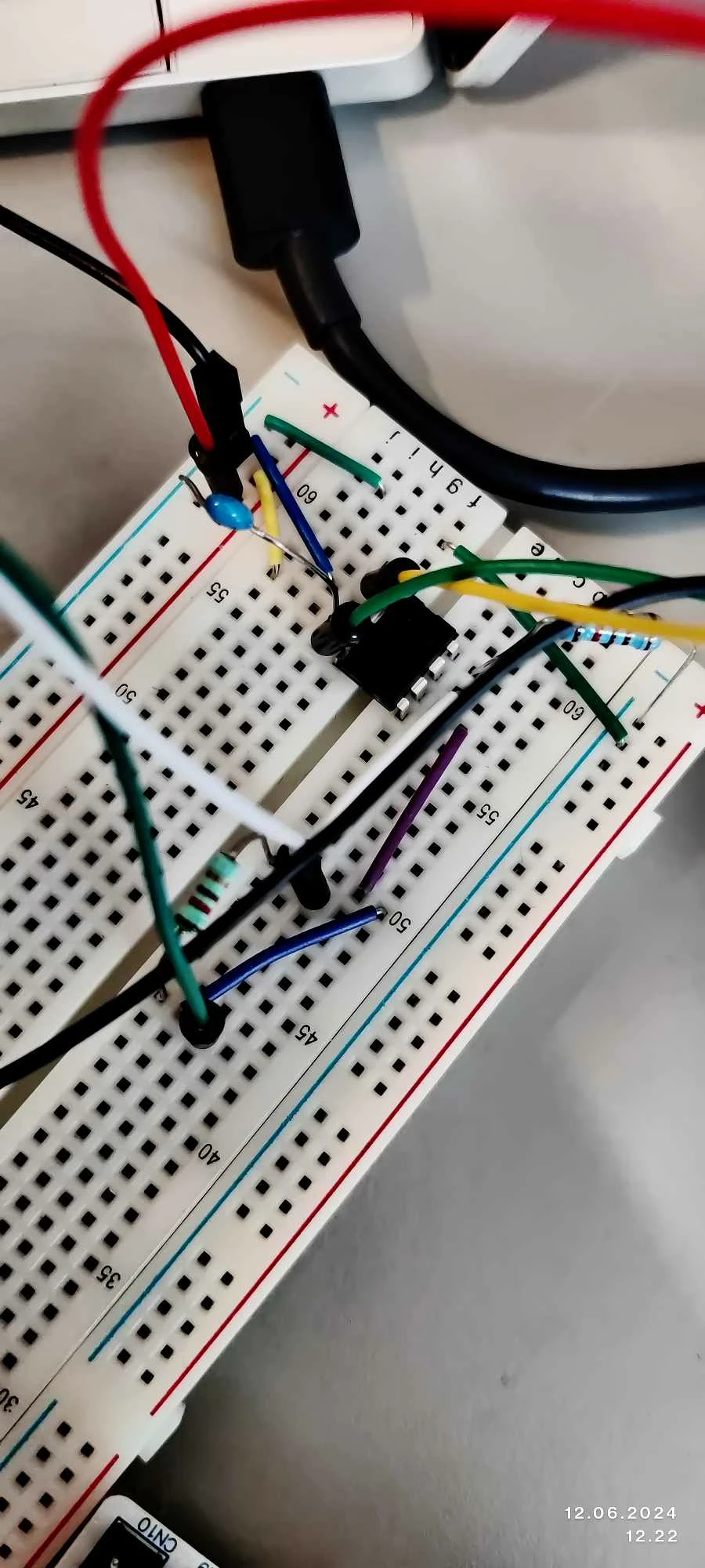

CAN-bus with STM32F103RB
Hello there!
I am trying to use some STM32F103RB Nucleoboards and some MCP2551 chips to make a CAN-bus. I got this problem where I can make it work in loop-back mode, but I cannot send from one board, to another one. I know the Circuit is stable and correctly weird, so I have deduced that it must be a problem with the code. I've provided a ZIP-file with the code that my group and I've made, and also some pictures of the setup in case you can spot anything wrong that I could not. We are somewhat sure that making a CAN-bus with STM32F103RB is impossible, but if any of you know what we're doing wrong, or if we are correct.
The code can be found in this DropBoxLink: https://www.dropbox.com/scl/fi/125mbvictjg6wwqbqnetw/CAN_BUS_KODE_BILLEDER_GRUPPE18.zip?rlkey=1z9k88380m35oaivu0i774j30&dl=0

As I understood, you have an issue with Tx and you said that in loopback mode, it worked fine but in normal mode not. Are you sure you have configured the same bitrate at both sides (the two available nodes on the bus)?
What about the transceiver? the image you attached doesn't give information but you need to provide a sketch or schematics to check the HW. What about the terminating resistors? how did you power the transceiver knowing that it's a 5V chip. What about Rs pin voltage level of MCP2551 which needs to be at least tied to the ground!
1 reply
