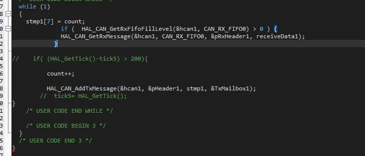

CAN Bus Protocol Transmitter doesn't work inside time-delay condition....
When I try to transmit can CAN data it doesn't work inside the time-delay condition... but it works properly without that condition...
Does anyone knows what's the issue?

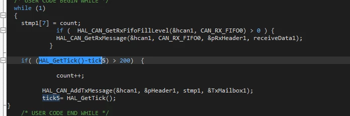

    Jan 24, 2023 2:30 PM UTC
    Do you initialize the tick5 value at loop entry?
    Is this in a callback?
    Does the tick count advance here?

    Piyush_Gupta
    Jan 25, 2023 2:51 AM UTC
    @Community member​
    I have initialized it as a global variable
    No, its in the main while loop
    I'm new to stm32, don't know what your question is....
    I just want to send data using CAN BUS at every 200-300ms. But when I try to transmit it in if(HAL_Getick() - tick5 > 200) it doesn't work....
    Tesla DeLorean
    Guru
    Jan 25, 2023 2:36 PM UTC
    Is HAL_GetTick() incrementing as each millisecond passes within the loop?
    If you send a character to a UART as well, can you see that occur periodically?
    Does HAL_CAN_AddTxMessage() return success or failure codes? Should you need to use more than one mailbox?
    I understand the goal, just not sure if it's not attempting to send at all, or if the approach here is wrong, or has unexpected modes of failure that you're not addressing or handling.
    Piyush_Gupta
    Jan 27, 2023 5:18 AM UTC
    yes, its incrementing
    I can't do this, it's a customize development board with no USB-UART TTL and no other free gpio pins, I will check the schematic again
    it return success code, but when I checked on oscilloscope, there is no signal...
    Javier1
    Principal
    Jan 25, 2023 2:40 PM UTC
    show us
