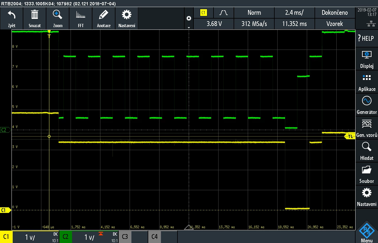

Hello.
I try init CAN bus. My CAN transmitter is MCP2551.
Connecting:
RX -> nucleoPB8
TX -> nucleo PB9
RS -> -----| 10K |----- GND
CANH - CANL 120R between
Vss - GND
Vdd - +5V
First step is:

}And when I go to this line:
if (CAN_Init(&hcan) != CAN_OK)I stop on this line:
while ((hcan->Instance->MSR & CAN_MSR_INAK) != CAN_MSR_INAK){
/* -TODO- timeout. Now only debug, init, ..... */
}And I don't know why. Any idea, what is wrong? I try looked for mistake in hardware.
On picture is pins TXD and RXD on mcu side.
Yellow is: TXD
Green is: RXD
