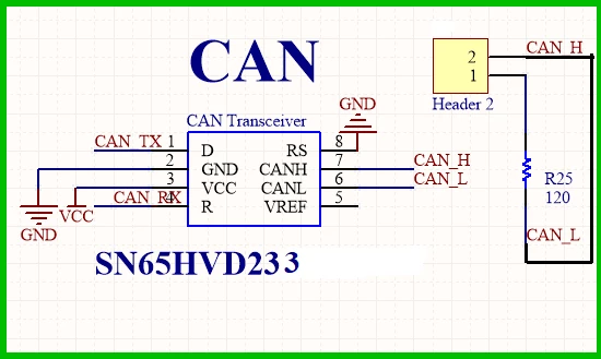

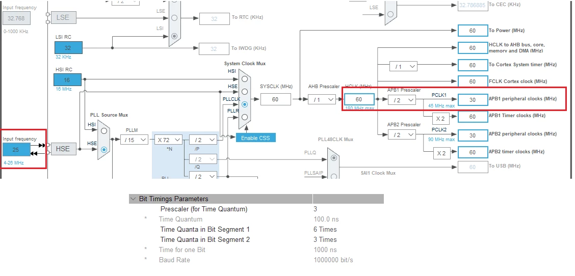

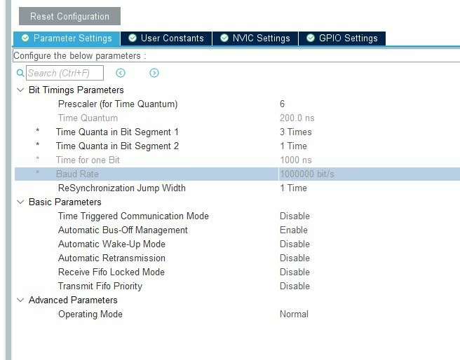

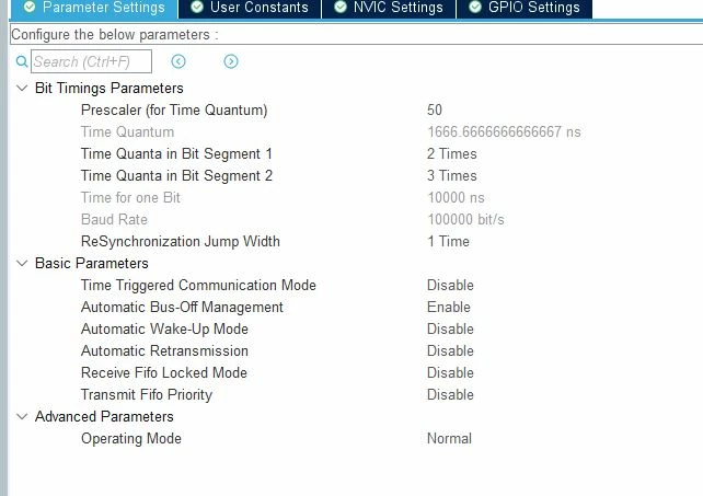

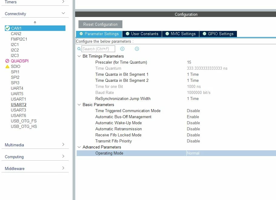

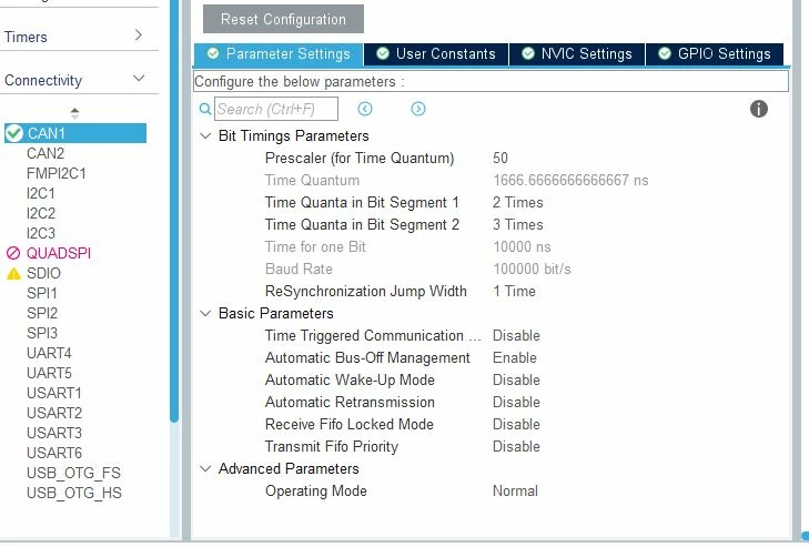

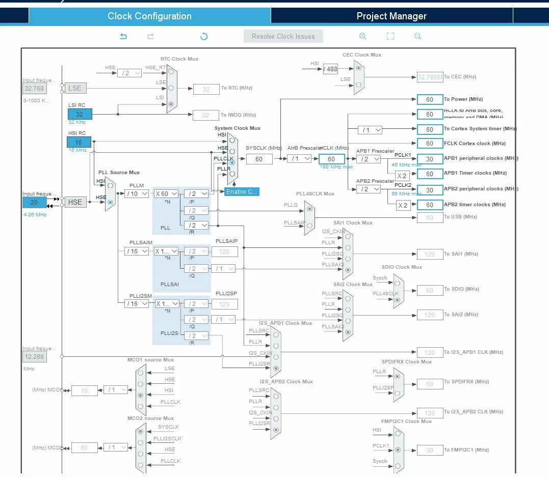

I'm using STM32F446RC controller CAN BUS 1. Trying to operate CAN BUS at 1mbps speed when using 100kbps bit rate it is working fine but not at 1Mbps bit rate. Is there any solution for this.
