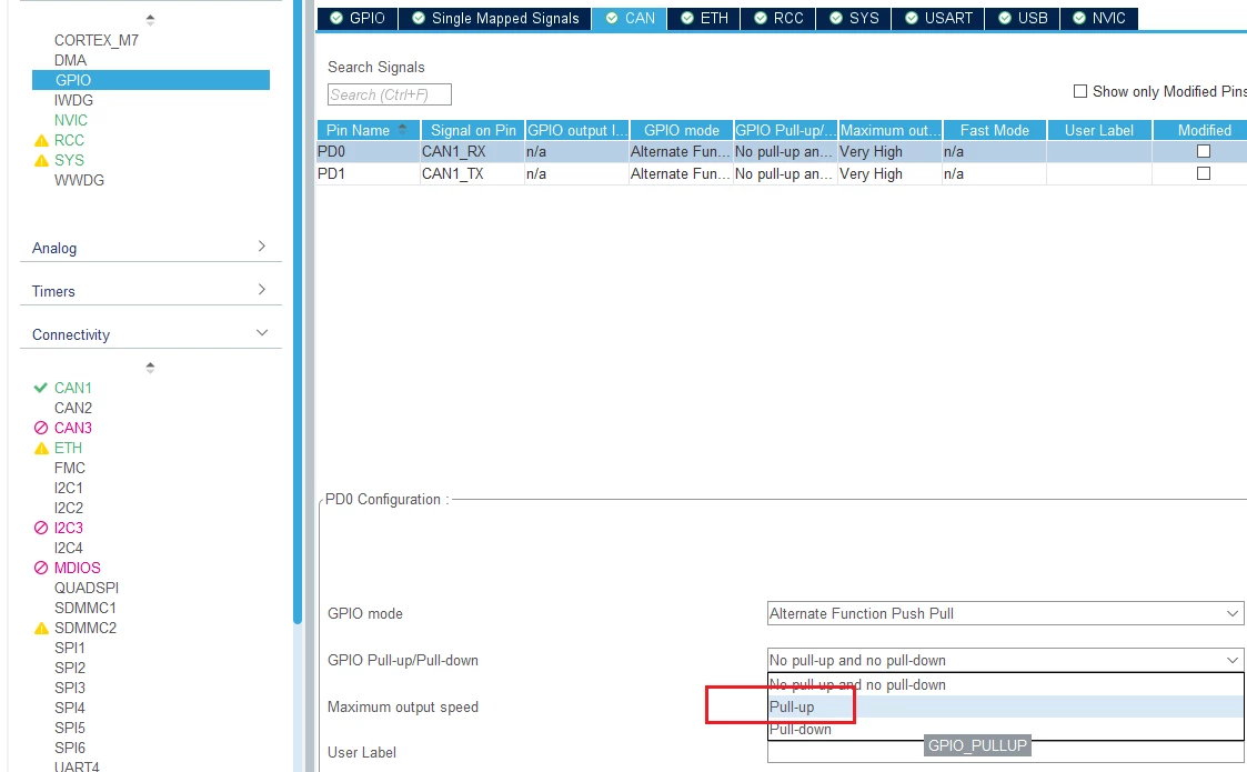

Second, set the internal pull-up on CAN_Rx pin:
Hope it helps.

vFazziAuthor
Nov 4, 2024 2:00 PM UTC
Hello SofLit and thanks for the quick reply, it worked immediately.
Can you please describe the relationship between the TxHeader.StdId and the filterMaskIdHigh?
