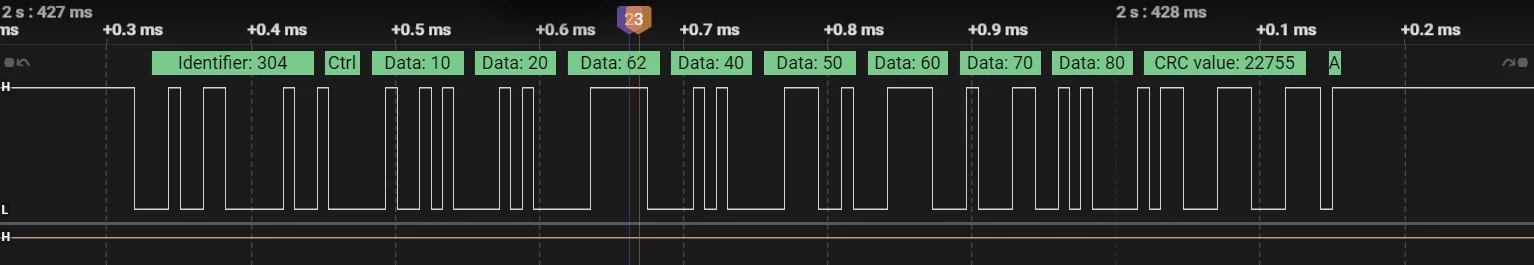

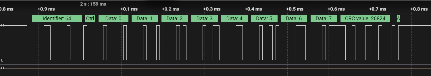

Hi, This is image (first image) and it is transmitted by USB to CAN converter (can bus identifier 64). It is received correctly on my Linux board (This converter also uses stm32F403). The baud rate is 125Kbps and CAN standard.

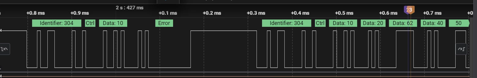

Now this is from (second image) NUCLEO-H753ZI  this frame always give error (can bus identifier 304) on linux board. But on USB to CAN converter it is received without any issue. I also check this on microchip CAN bus analyzer and it work there also. But not on Linux board. I also send frame form CAN bus analyzer and it is received correctly on Linux board.

I capture these waveform on the linux board CAN-RX pin.
Here you can see after error the frame is again transmitted correctly but not received correctly and show as error.
This frame (frame 3) is same as above but screen short of correct frame(this is also not received)

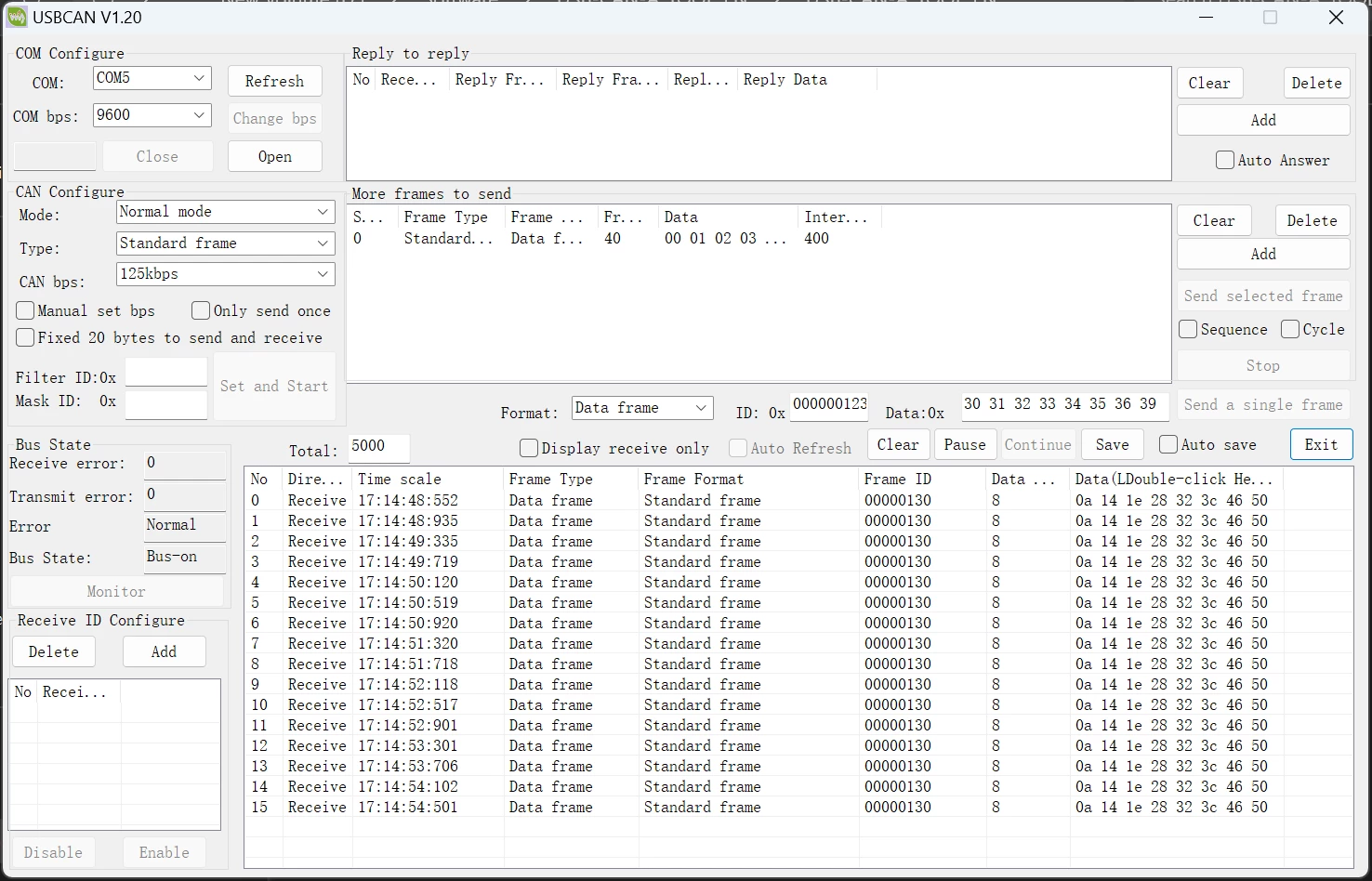

Yes, When I remove the Linux board and connect only NUCLEO-H753ZI board and USB to CAN converter, it work without any issue. Even I keep linux board then frames from STM to converter are received. The frame transmitted by STM is received on converter but not on linux board. Please note - No filter are used on any device to make sure all frame are received on all devices.
The CAN to USB converter also uses STM32F103 microcontroller. So if you can tell what CAN config used in this type of device then I can try it also
This is screenshot of can to usb converter in which I am able to recive data..
