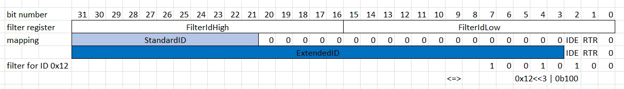

I'm using extended ID for my CAN bus. I want to filter ID 0x12.
My code is working well when I receive an extended ID frame with containing the ID 0x12. If the received ID is something else than 0x12, the FIFO callback isn't triggered.
CAN_FilterTypeDef sFilterConfig;
 sFilterConfig.FilterBank = 0;
 sFilterConfig.FilterMode = CAN_FILTERMODE_IDMASK;
 sFilterConfig.FilterScale = CAN_FILTERSCALE_32BIT;
 sFilterConfig.FilterIdHigh = 0;
 sFilterConfig.FilterIdLow = 0x12 << 3;
 sFilterConfig.FilterMaskIdHigh = 0;
 sFilterConfig.FilterMaskIdLow = 0xFF << 3;
 sFilterConfig.FilterFIFOAssignment = CAN_RX_FIFO0;
 sFilterConfig.FilterActivation = ENABLE;
 sFilterConfig.SlaveStartFilterBank = 27;
HAL_CAN_ConfigFilter(&hcan1, &sFilterConfig);
However, when I receive a standard ID frame, whatever the ID is, my FIFO callback is triggered.
So I'd like to discard all the standard ID frames that I receive so that they won't trigger my callback, how could I do it ?

Should be able to add the IDE bit to mask/compare​

thanks clive, I hadn't thought about it. now it works with filtering/masking the IDE bit:
sFilterConfig.FilterIdLow = 0x12 << 3 | 0b100;
sFilterConfig.FilterMaskIdLow = 0xFF << 3 | 0b100;
here's a pic that helps to understand :
